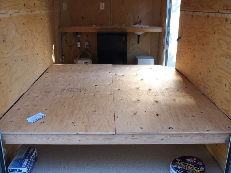

Completed the bed frame and it's ready for placement of the electrically inflatable air mattress. Man, what a pain working and cutting 4x8 sheets of 5/8" plywood by yourself using a table saw. Had to do some supertrick juggling to get that done.
:sneakers:
By the way, in case anyone is wondering, the bed frame was built to fit a Queen size mattress (62" wide x 80" long). If that proves to be more than we need, well we can easily go smaller. Once built, well it is easier to go smaller, such as to a double ("Full Size") mattress (typically 54" x 75") than it is to go larger.
I've got room underneath the bed frame to store the Honda EU2000i generator, gas cans, propane tanks, 13" slide in plastic storage bins, or up to 17" drop in plastic storage bins, the latter requires lifting the 5/8" plywood deck to drop the 17" bins in.
As a side note, what you see is not what it will look like in final form. All the plywood wall surfaces will be covered in a nice final finish paneling.

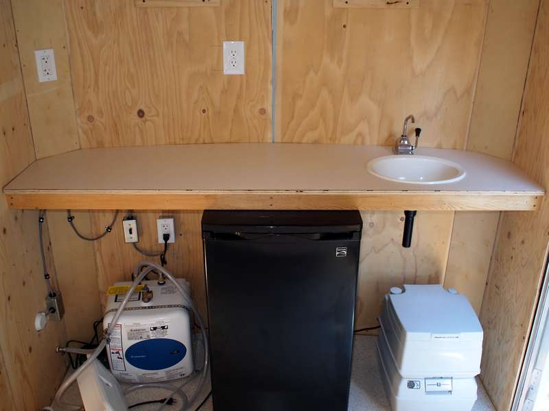

Got the Formica cut and installed. As I imagined, geez what a pain that stuff is to work with (cut). I tried tin snips, as suggested by a You Tube video, but that didn't work well cutting a long length (started to chip). Finally ended up cutting it on the table saw, and that was dicey. I only had one shot at it (only had one piece long enough to fit the width of the counter top i.e., bought a remnant locally off of Craigslist), but it worked out OK in the long run. Next was gluing it in place. I used contact cement as suggested by the Home Depot folks. I applied it to both surfaces as stated on the can instructions. NOTE!!! When using contact cement you only get one shot at placing the Formica because once down you can't move it. It is stuck in place. It wouldn't be so bad doing a free standing counter where you could slap down an over size piece of Formica and trim to fit. No such luck for me. I cut the Formica to a pattern I made and had to install (glue) it in place in a confined space (defined borders). A pain in the rear but, thankfully, it turned out OK.
Also wired in the Battery Tender.
I suppose that doesn't sound like much progress but it took me all day to get that far along. We're almost "initial run" camp ready. Just need to finish plumbing the hand pump sink and drain and we're good to go. Final interior finish will come later this Fall/Winter.

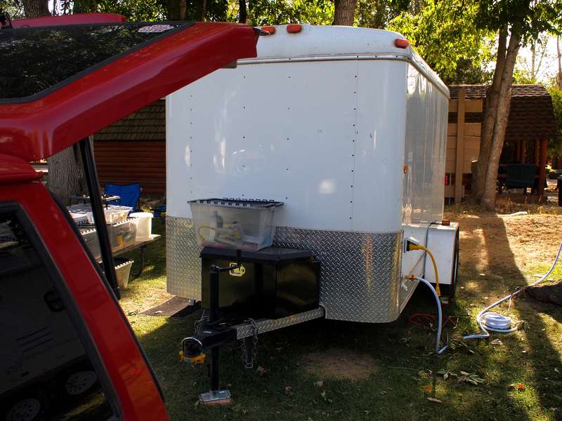

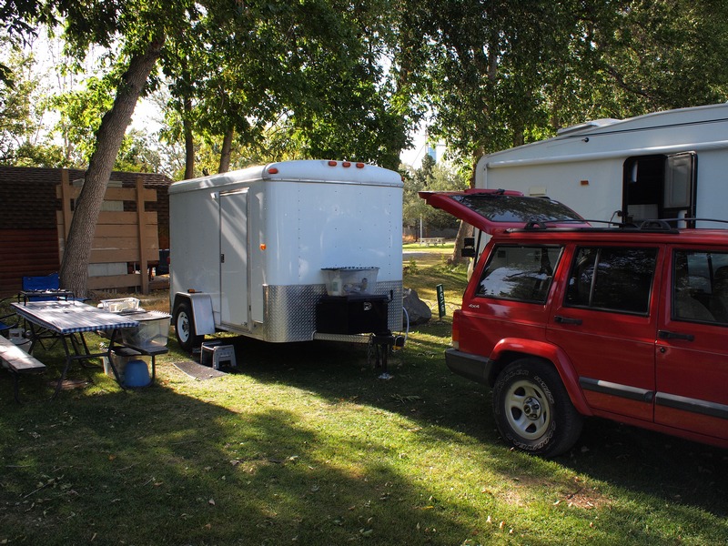

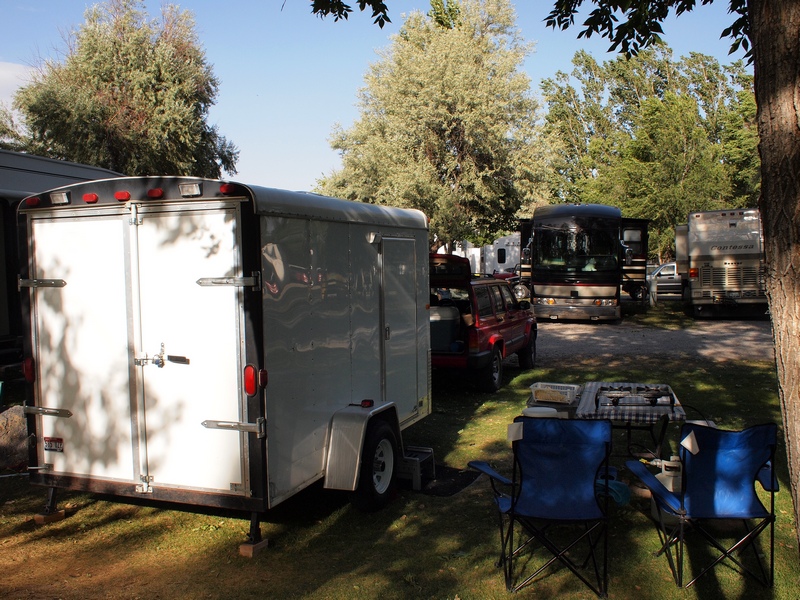

We took our converted CT out for its initial camping trip over Labor Day Weekend (2010). It was a super push to get it complete enough to go but go we did.
We drove a total of 648 miles over the weekend, about 500 of those towing the cargo trailer to and from Idaho Falls, Idaho (approx. 250 miles one way). It towed great! We did some day trips, which added the additional (approx.) 150 miles.
We based ourselves out of a fairly nice, though somewhat expensive, campground in Idaho Falls (that's what happens when you don't plan trips in advance and find you have to take what you can get on a busy weekend when you arrive late in the evening) and we did day trips from there. Went to Palisades reservoir on Sunday, what a beautiful lake in eastern Idaho, well up in the mountains. Found some great camping sites there for future trips. Also found (saw it going to Idaho Falls and then stopped by on the return trip) a great spot about 2 hours from Boise on the Big Wood River (near Sun Valley) that we can camp at for free (dry camping).
Learned a lot from this initial trip with the CT and will be redoing my design. The big queen air bed was really comfortable and roomy for the two of us to sleep on but is simply too big for the CT in that it takes up most of the room in the trailer.
Sunday in Idaho Falls, especially in the evening, it was cold and very very windy so it would have been nice to have more room to sit inside the trailer (we had to sit and cook outside and endure the wind and cold because there was no room in the trailer, the queen bed takes up a huge chunk of real estate inside a 6x10 CT). So I will redesign with a pair of bunk beds crosswise to the trailer in the aft end giving us room to sit inside, room for a small table, and more room to move around inside should we want too. Still, it was a great trip and so nice to get away and try out the CT conversion.
As to the home 110v AC appliances in the CT, well they worked out great! The cheap Sears home/dorm reefer worked perfectly. I plugged it in the day before leaving to get it cold. We then stocked it the night before leaving on our trip with foods we wanted cold so they and the reefer would be cold. I also froze a large block of ice in a plastic Tupperware type container in our home freezer the night before that would fit inside the little Sears reefer freezer. I put the ice block in the Sears reefer freezer just as we left on our trip i.e., once I unplugged the reefer from the 110v AC connection at home. It kept everything in the reefer cold during our 4 1/2 hours drive from Boise to the Idaho Falls campground in 95 degree heat. Once we arrived at our camp site and the reefer was plugged in again, it froze solid from its slight melt and was good for our 6 hour return trip (we took some side roads and casual stops on the way back), once again keeping everything cool in the entire reefer.
I left the cheap Sharp carousel microwave oven on the galley counter top lashed to the wall using some nylon tie down straps I found at Home Depot. Same with the Porta Potty, the heavy cast iron propane stove, and the Honda EU20001 generator, the latter were all lashed to the sidewalls but sitting on the floor of the CT. Everything stayed in place during travel... and that was a relief. And while we went over some poorly graveled (rough) roads and bumpy terrain it was good to see everything stayed where it was supposed to.
I bought a 5 gallon plastic fresh water tank and some 2" wide adhesive backed Velcro strips and stuck Velcro to the bottom of it, and opposing Velcro to the floor. Filled the fresh water tank with 5 gallons and stuck it to the floor via the Velcro strips. It stayed perfectly in place for the 500 miles over some semi-rough terrain. I also used the 2" Velcro to secure the Sears reefer door so it wouldn't open during travel.
Again, it was a great trip and a learning experience for our first outing in our CT conversion! Pics of our CT in the Idaho Falls campground follow. We were the smallest trailer there, needless to say, but never felt inadequate. In fact I have to say we felt a bit smug thinking how little we have spent to sleep comfortably in the same campground huge expensive rigs were in because, even in the wind and cold, most of the huge rig owners were also sitting outside of their rigs sipping toddy's as we were. :cheerswine:
Stealth camping at its finest! :twisted:

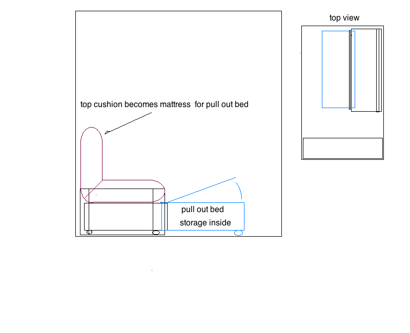

Thinking instead of traditional bunks, the trundle bed setup which would essentially be a comfy sofa /seating area by day( Only 28" deep) , and a couple light TV trays (anybody remember those ? ) would solve your sitting /dining problems and still be stealth simple ... just an idea... :roll:
Something like this , with lots of storage below , easy to access... Image
GPW,
I'm thinking of using the existing E-Track and adding more E-Track above to make bunk beds. With the E-Track everything can be removed to make it into a cargo trailer again.
I like your trundle bed design but am not sure I truly understand it. Does your design mount (or sit) on the side wall and run the length of the trailer or is it intended to go crosswise? I prefer to go crosswise since I have the E-Track wall mount rails already installed for the lower bunk. It would only be a matter of adding a pair of 2.5 ft. E-Track rails above the existing E-Track rails (in the aft end of the trailer) to install an upper bunk. Also, a trundle bed that mounts and pulls out from the side (or the rear) eats up floor space when let out for sleeping whereas bunk beds don't. What I am after now is max floor space without having to move things around i.e., I am thinking "Go vertical."

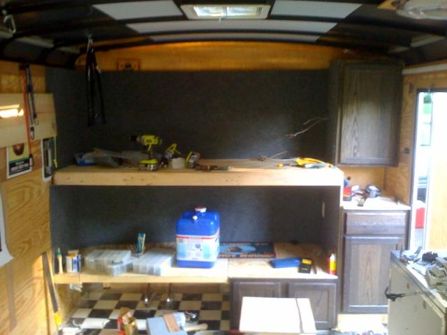

Postby vtx1029 » Wed Sep 08, 2010 11:34 pm
We did bunk beds in our trailer and it worked out awesome! The top one is fixed but half of the lower one lifts up so we can get our bikes in there 8)
Sorry about the mess :lol:

Postby d30gaijin » Thu Sep 09, 2010 8:22 pm
vtx1029 wrote:We did bunk beds in our trailer and it worked out awesome! The top one is fixed but half of the lower one lifts up so we can get our bikes in there 8)
VTX,
Mess or no, that's a nice looking setup How wide is your CT? Mine is only 5'9" inside side to side and I'm 6'1" but I mostly sleep on my side so bunks in the rear should work. I'm going with the E-track so both bunks will be removable to get the Harley in when we want to take it along, not to mention I already have the E-Track hardware, just need to reconfigure it for bunks.
Another thing I noticed about the inflatable air mattress that, while it is very comfortable, it gets cold in the early hours of night/morning on cold nights when there is no heat going in the CT. It's sort of like sleeping on a water bed that has no heater, though not as cold as the latter.
