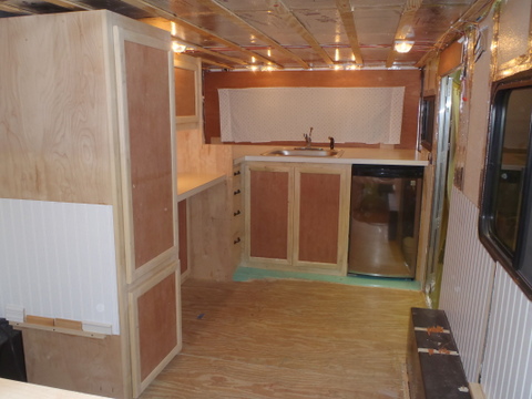

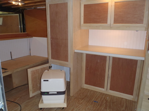

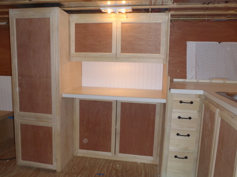

Ready to start paint and wallpaper
Postby pmspirito » Sun May 27, 2012 8:47 pm
Today Dad and I installed all of the cabinet doors and the drawer unit under the kitchen counter top.
