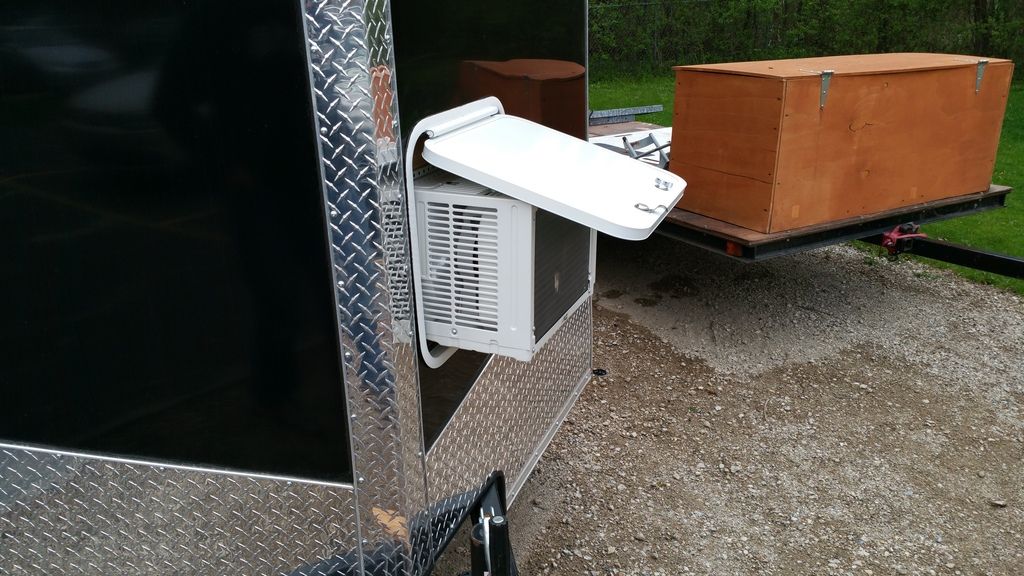

I realized my first use of the trailer is this Friday -Sunday for two track days! So I took a look at what I "needed" to get done before them. Air conditioning was on that list because it's going to be in the upper 70s and humid.

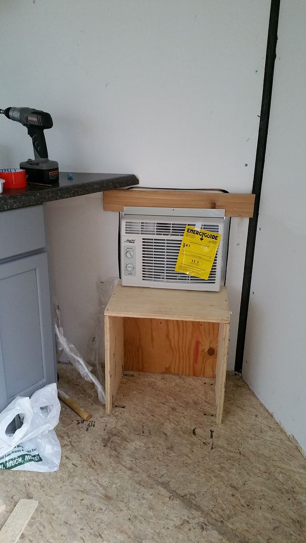

After trying unsuccessfully to mount the shelf i made, my dad and I decided on making a box without a bottom. It's very sturdy, and will hold my weight because there is plywood on the back of it. And the ac unit fits under it for transport temporarily. Eventually it will be mounted on slide outs, but for now I was able to utilize the window bracket and a piece of wood to prevent it from sliding out. No shaking or noises while running either!
Once I get sliders on there permanently, I can still utilize the space under it for storage. And obviously it will be painted.

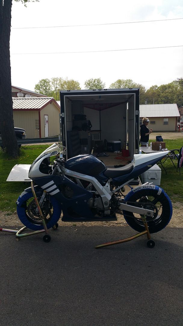

I noticed when I put my motorcycle in, the engine ended up in front of the axle. What I will do is flip the restraint so the bike points to the rear. This should put most of the motorcycle weight behind the axle instead and help with tongue weight.

So I flipped the trailer restraint around and the weight of the motorcycle was behind the axle which was good. I also placed my ~100lbs generator behind the rear axle during transport.
Doing 65mph and some city driving for 180 miles got me 11.27 MPG, in my 4runner in which I normally get 17-18, so a 36% reduction in MPG isn't too bad, considering I was towing 3000lbs in a 6.5 ft interior height trailer. Overall, I spent about $15 more on fuel for this trip, but was much more comfortable sleeping in the trailer than the tent.

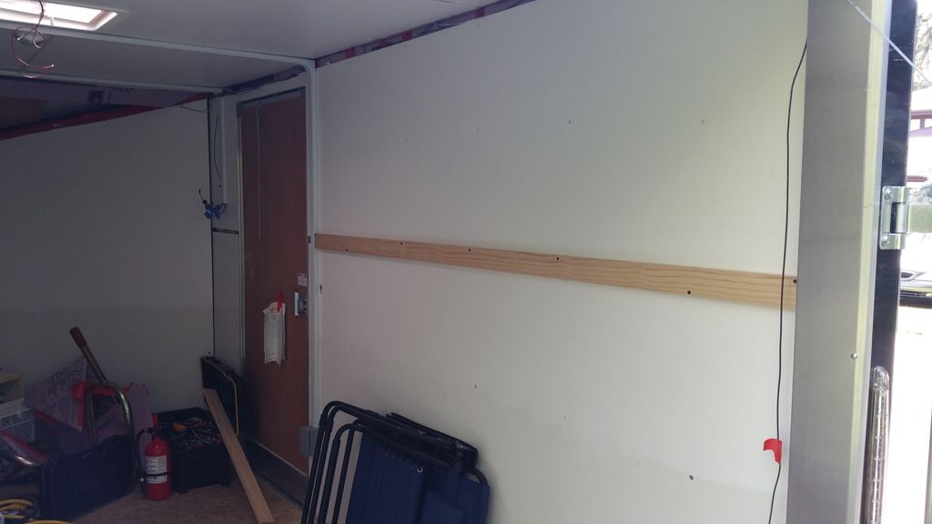

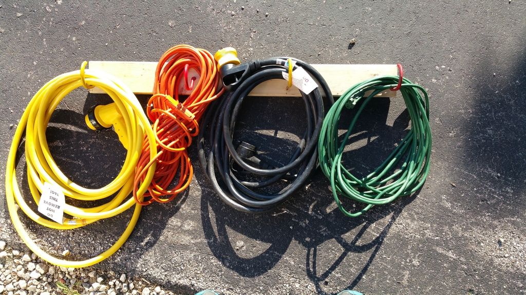

Since I'm over budget, I went with a simple wall hook system instead of e track or Rubbermaid fast track. Grand total cost? $0. Just a 2x4 and some garage hooks I had lying around. It gets all my cords off the ground. I will make another for my motorcycle stands. Once I paint it it'll look nice.
In the future when budget permits I may upgrade to something else.

There is nothing wrong with that approach. I used the same hooks for my hunting trip last fall just to get me through the deadlines. And it gives you more time to think about what you really want/need.

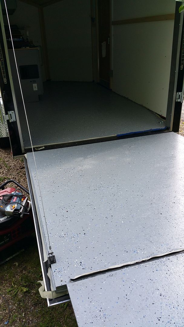

Decided to go with the durable Rustoleum Garage floor epoxy. It was $49 at menards. I also got the anti-skid additive. After using my trailer the other week, I realized carpeting would have been a bad idea, and that I'd need something waterproof instead. I should be able to cover my floor and ramp with this. If I have extra, i may do under the trailer.

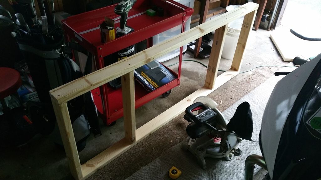

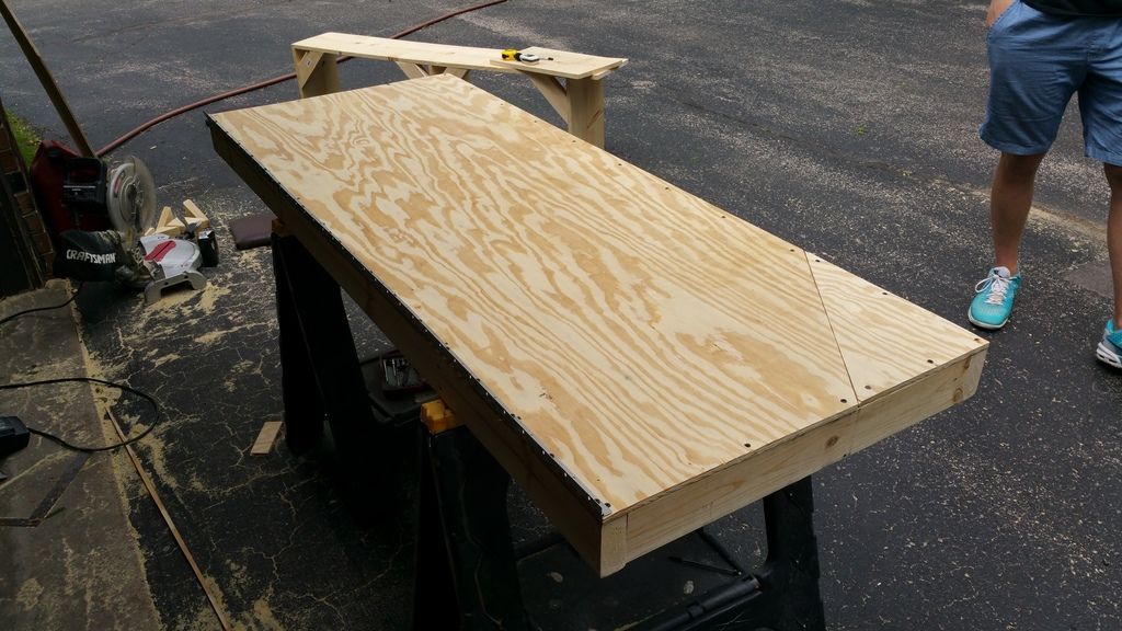

I also built the frame for my fold-down bed today. I need to put plywood over the top still, and build the part that attaches to the wall.

-Finished fold down bed, just need to mount it in trailer. You can see the frame that goes against the wall at the top. I made it 16" high so I can store certain things under it.

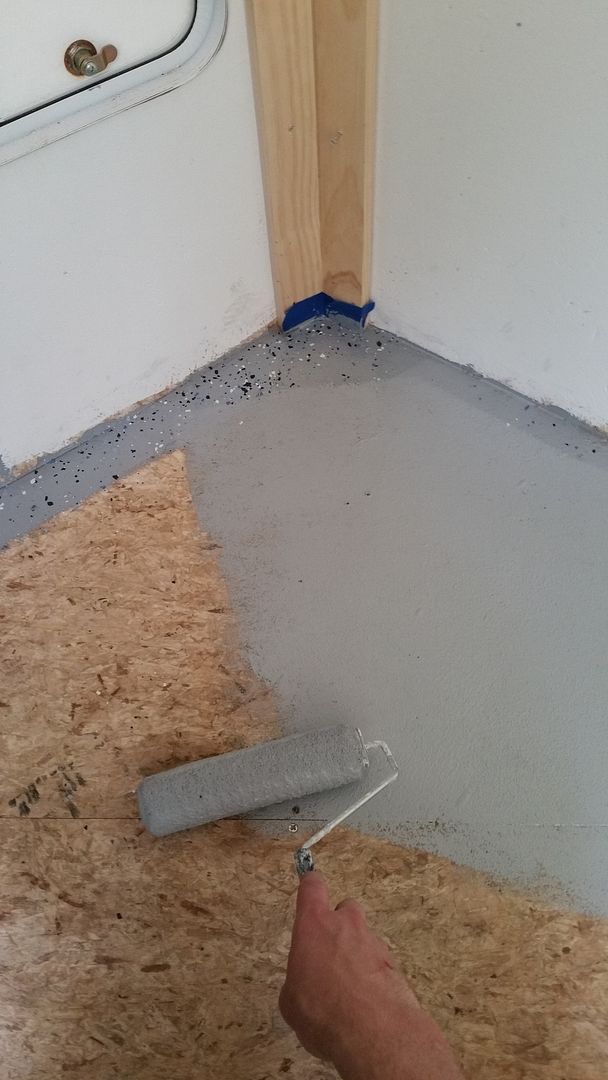

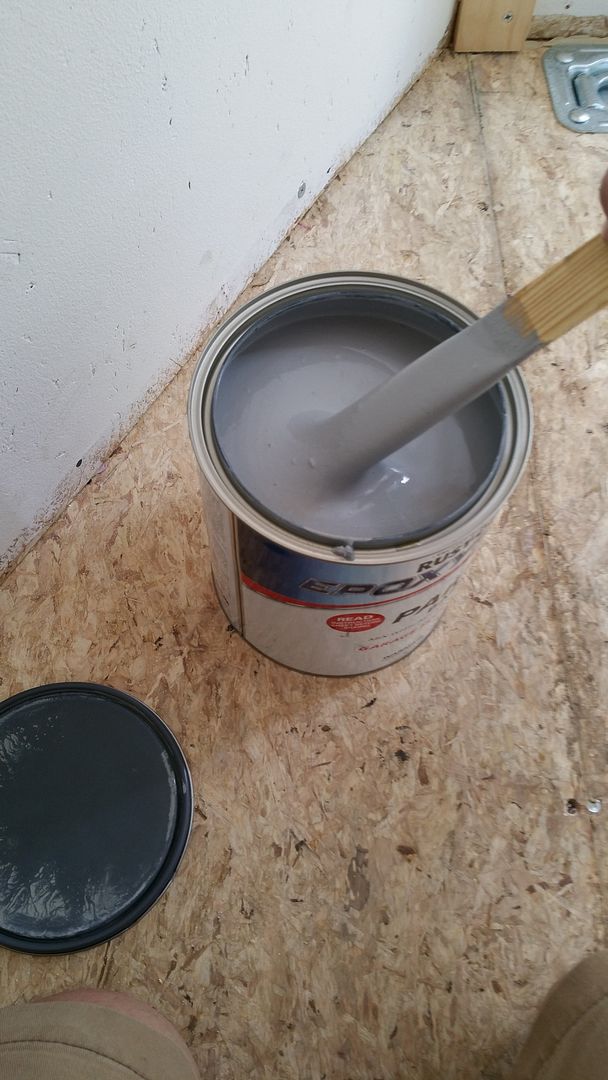

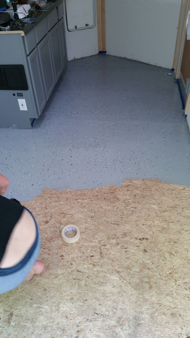

-Laid the Rustoleum Garage Epoxyshield. I highly recommend this stuff! It looks like it's going to be perfect when it's done. I just vacuumed the floor real good, mixed it up, and laid it down. I used a trim brush near edges and around the tie downs. I taped off any nice trim pieces. For laying the decorative chips, just tossing them up works nicely. I did the ramp door too. I had probably 1/6 of the gallon leftover.
Now I just have to wait a day or two for it to cure, and then I can install the bed frame and begin painting!

Thanks for posting this. I may give it a try. I want the Allure vinyl planks, but since I will paint the floor first anyway I might just go ahead with this covering and that lets me put the vinyl cost out later in the porcess.

lrrowe wrote:Thanks for posting this. I man give it a try. I want the Allure vinyl planks, but since I will paint the floor first anyway I might just go ahead with this covering and that lets me put the vinyl cost out later in the porcess.
Yea, I wanted carpeting, but after seeing how wet and dirty the floor can get, I wanted something more waterproof. I could still lay carpet in the future if I wanted.
They also have different colored paint chips you can get too, if the white and blue isn't your style. They also have tint base too, so you can get other colors for the epoxyshield.
