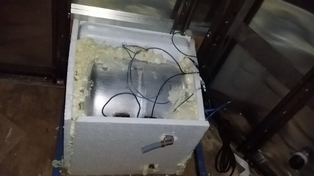

I didn't have much time tonight, but I did get the Hot Water tank mostly insulated. I need to get a small piece of fiberglass insulation and some cardboard , and some packing tape to seal this all up and then cut an access for the thermostat and thermal breaker I installed for the electric element. I am letting the expanding foam set up tonight. This tank will be better insulated than the original thin layer of fiberglass and cardboard I took off when I removed it from the donor camper. That will definitely help with the propane, and/or electric consumption.

Re: 7'*18' V-Nose Cargo Trailer Toy Hauler Conversion
Postby McDave » Thu May 12, 2016 12:27 pm
Keeps hot water hot, keeps heat out of cabin. Win/Win.
Postby flboy » Thu May 12, 2016 1:08 pm
Yes... that is the general idea.Thanks.
I just hope I never have to remove this tank. If so, will have to destroy the insulation and do it again. When I got done spraying in the foam, I realized the insulation and foam is wider than the installation hole. Odds are slim in any case, all the stuff that breaks on these are on the outside. The tank itself would have to fail to actually remove it. In that case, I'd be replacing it anyhow.

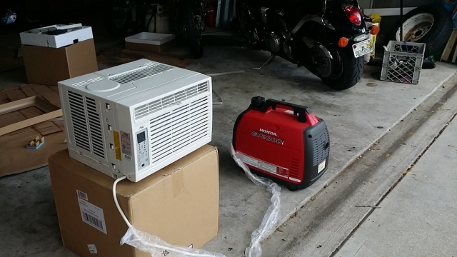

Gave the AC a dry run with the Honda EU2000i today. It powers the 6000BTU fine in normal mode; however, the inductive current inrush on the compressor motor causes it to kick out when the Generator is in Eco Mode.The Generator can't react and throttle up quick enough. The the AC sees a voltage sag and assumes low voltage and kicks the low voltage relay and turns the compressor back off. It is built in brown out protection. When the compressor is running, I can put the generator back in Eco Mode and the Generator runs slightly above idle. The AC only draws 500 watts running, but the initial/start up current draw can be as high as 3 to 5 times the running current.
There are some "soft start" capacitors in the aftermarket you can add to the Air conditioners. I may buy one and see if it works. It would really be nice to leave the generator in Eco mode. It will use probably only about a third of the fuel. We'll see. I guess it is worth a try. I will have to cut some wires and modify the circuitry inline with the compressor motor which I am sure will void the warranty. That being the case, I may give it some use before I mess with it. :thinking:

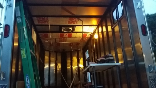

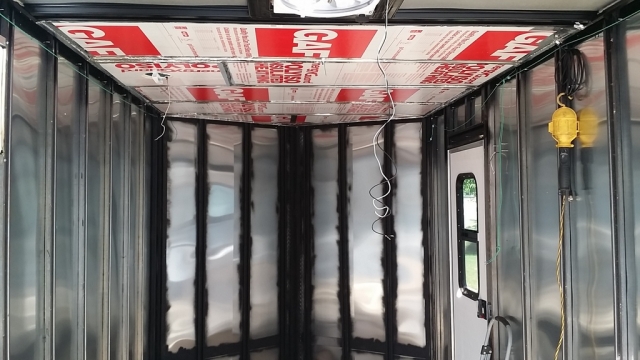

I started the insulation in the ceiling. When I get this part done, I will be putting in furring strips to attach the Luan plywood to later and then adding another layer of insulation between the strips for ~R10 total in the ceiling. The hot Florida sun is not forgiving. I will only do one R5 layer on the sides. The door side will have an awning to keep the sun off... In any case.. It should be well insulated and sealed.
You may notice the black paint up front. The trailer builders do not really treat the bare metal carefully and every trailer I have ever opened up or saw opened up, had rust on the studs. They just don't paint them well. While it is all apart, it is easy to spray them with Rustoleum Rust Stop Primer. The front took two cans, so I may need about 8 more for the sides. I'll also be removing the floor wood and brushing on a thick coat of rustoleum all over the chassis and also sealing the wood on the bottom with marine varnish before re-installing. They did not treat that well either and I don't want my floor rotting out over time. This stuff is easy while it is deconstructed..... and relatively cheap, even though time consuming. Hope I am not over doing it.

I added another panel or so to the ceiling tonight, painted some more studs with rustoleum, and finished putting additional Dicor sealer over all the seams along the outside perimeter of the roof. My goal is to get the ceiling finished with furring strips by the weekend and start on the walls and wiring.
