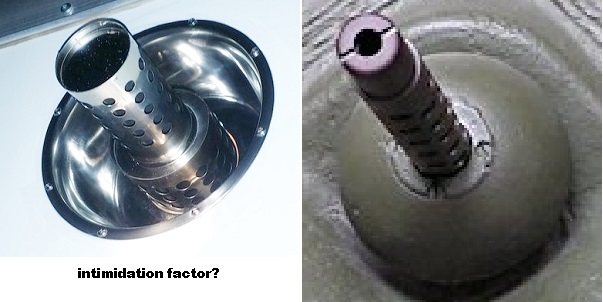

You do great work! Very nice. :thumbsup: :thumbsup: That almost looks like some sort of anti-aircraft gun barrel. :thinking:

Postby working on it » Tue May 02, 2017 7:49 pm
Nice, but a little intimidating.
port-heater or mg-.jpg (61.11 KiB) Viewed 4689 times

Postby Iconfabul8 » Wed May 03, 2017 8:46 pm
Thanks Guys! Yeah, I was thinking I would probably get a few artillery comments. Haha
