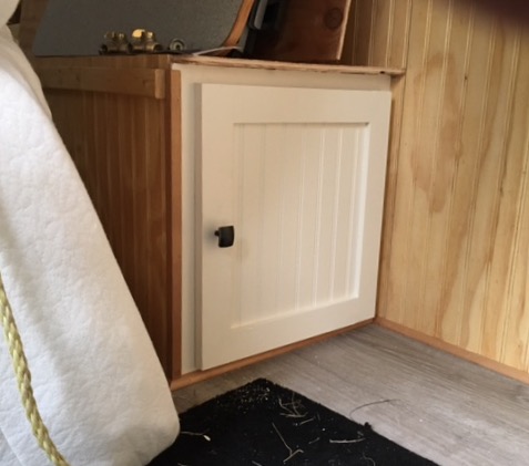

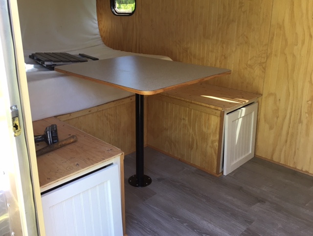

Postby fourbtgait » Sun Aug 27, 2017 2:23 pm
That was the smallest silver. My wife lost one right at the boat that would have gone 3' long.
All trout were catch and release.
Back to work...
Dinette table in, doors all primed.

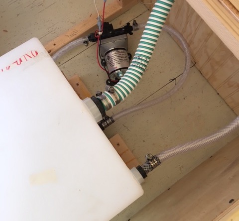

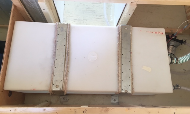

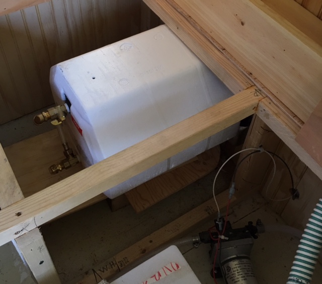

Postby fourbtgait » Sun Aug 27, 2017 6:06 pm
Water tank in, secured. Hoses for water fill/vent, to pump run. Pump works.
Had one small leak on the water fill hose.

Re: 6x12 build
Postby Padilen » Sun Aug 27, 2017 6:12 pm
That tank isn't going anywhere!

Postby fourbtgait » Sun Aug 27, 2017 7:45 pm
Makes me wish I had looked at the tank in the TT and 5th wheel to see attachment!

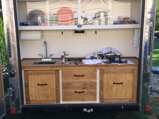

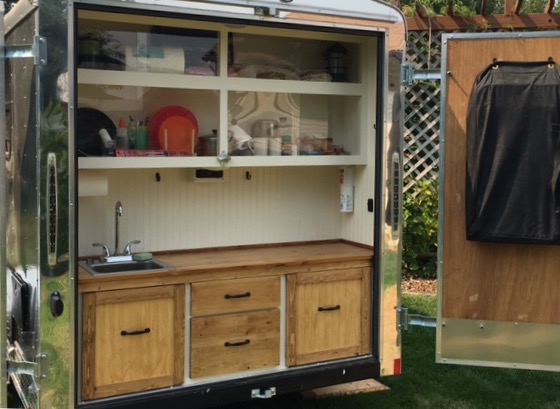

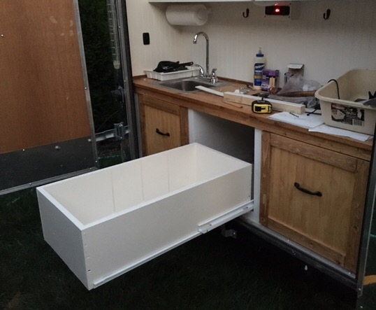

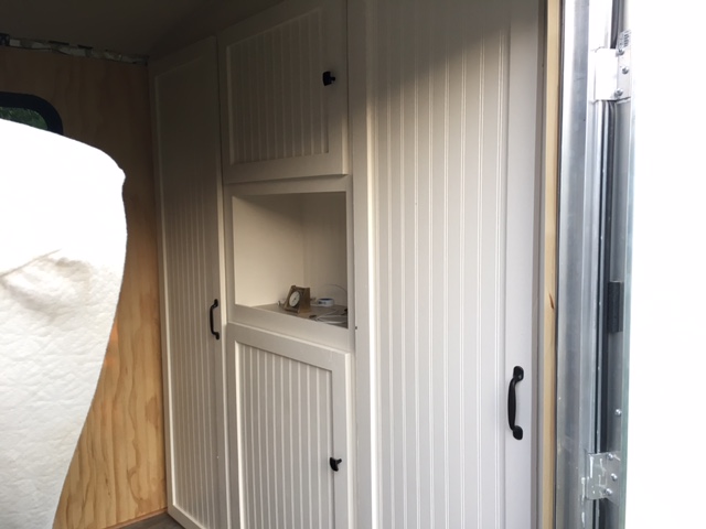

Postby fourbtgait » Mon Aug 28, 2017 10:08 pm
Cabinet doors hung, still need latches.
One kitchen drawer in, had the drawer slides left over so was working from memory with them.
Water heater also showed up early, work never stops.
Especially when archery season starts Friday.

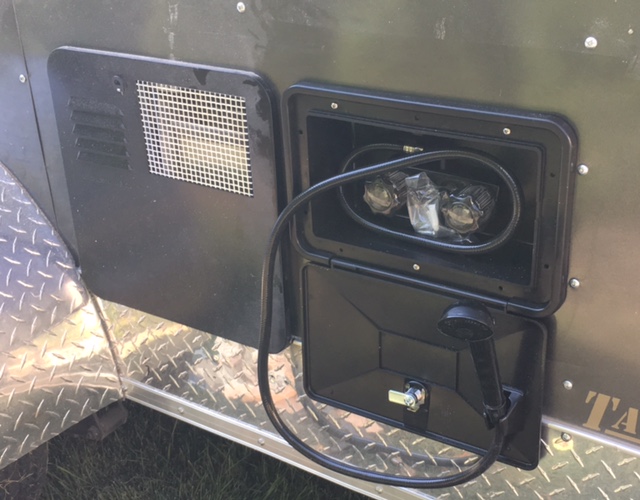

Postby fourbtgait » Fri Sep 01, 2017 6:57 pm
Drawers in.
Water heater in.
Outside shower in.
Tomorrow will be a pex kind of day.
And no, I have not made provisions for propane yet. Initially was goung to put a tank on the hitch, but leary of the weight with a spare and battery. Thought I would weigh the tongue dry, then loaded. My calculations show a dry weight of about 2,200. Kind of thinking simply carry the tank loose. Have a quick disconnect for the water heater and stove.

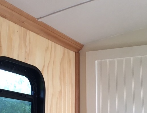

Postby fourbtgait » Sun Sep 03, 2017 4:40 pm

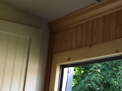

Interior trimmed out, need to touch up ceiling paint.
Replace 2 bed supports, though not critical, they are on her side at the head.
All that is left is:
1. Nose tray
2. Propane line
3. Barn door insulation, blocking for drop down table
4. Brakes
I do have a solar panel for it but not going to bother mounting it. We draw so little power.
