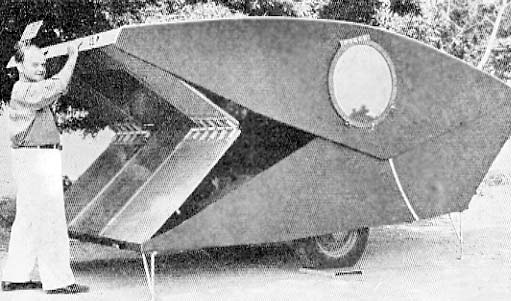

Or you could do something like this (below). Now THAT would be interesting...

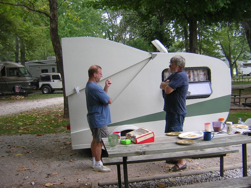

This is commercially done and practical for those with not much parking space. Or only now and then need for a utility trailor. The following is a pic of mine. If your building your own, put some hard plastic skids on the bottom, put a fancy hook on the back, strap it to a tree or solid something, and slowly pull the trailer out from under it.
When you want it back on, I recommend using a boat winch bolted to the tounge, as opposed to a wench or a wrench. :lol: {though wenches are more fun}
