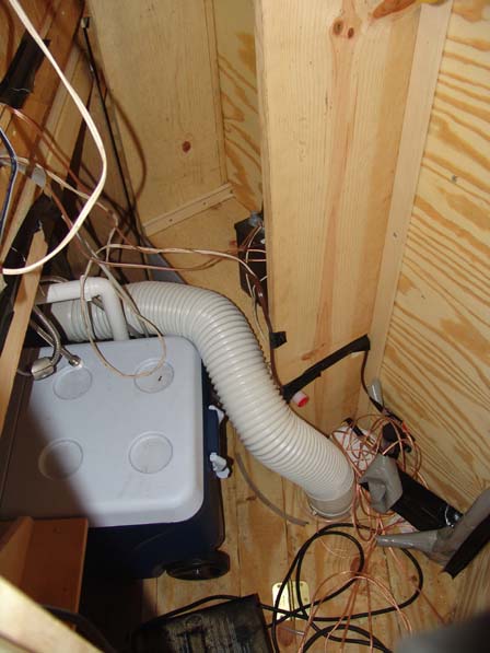

Postby jwhite » Fri Jun 11, 2010 9:20 pm
After doing some resarch on what type AC to put in my 7x16 and I went with a 12000 btu portable AC and ran the vent out the floor shown in the photo,it does give off some heat and I may wrap the vent hose with insulation.
I bought it off Ebay > compact appliance I think is the name of the company I paid 350.00 and it was shipped free,I think the factory wanted 1500.00 and I wasn't willing to go that much so I bought this one.
So far it has worked good not great it does take a long time to cool the trailer down,
I live in South GA and it was 90 when I started it today at 2oclock and it is at 72 right now if I run it all night it will get down to 60.
from what I have read on other message boards that in the middle of the day it is hard to get any AC to cool a big area down?
the only thing that helps in my trailer in the middle of the day is sitting right in front of the vent as it's blowing.
One big factor for me was that I plan on useing a honda 2000 generator
and it puts out 13 amps and the AC needed 8amps,as soon as I got it I plugged in the AC and my Microwave and ran them both at the same time and had no problem running them both which I don't plan on doing but just wanted to see what would happen.
I also insulated it really well with 2 layers if foam and sealed it tight.

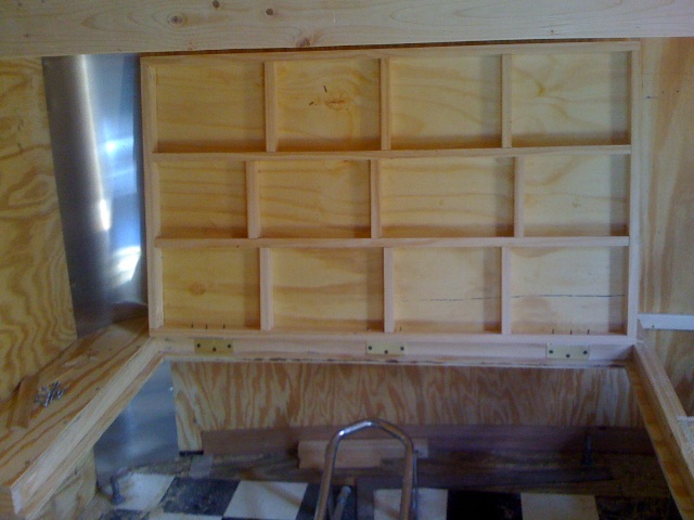

Postby Frank ZX » Thu Jun 17, 2010 10:10 am
[img]http://i201.photobucket.com/albums/aa281/FrankZX/Picture485-1.jpg
This is the Trimark door latch.
[/img]http://i201.photobucket.com/albums/aa281/FrankZX/Picture484-1.jpg
[img]http://i201.photobucket.com/albums/aa281/FrankZX/Picture483-1.jpg
[/img]http://i201.photobucket.com/albums/aa281/FrankZX/Picture477-1.jpg
I cut the cabnet down to 17" deep.And added a small sink and 2 burner stove.
I also added a small A/C unit in the back door.It seems to be doing a decent job of keeping it cool.
