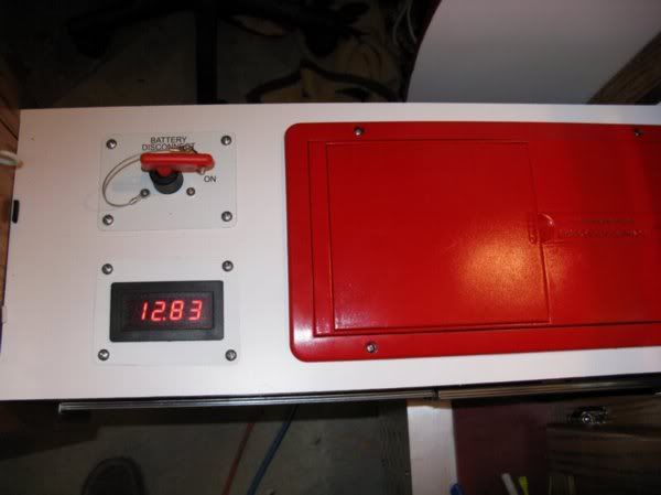

Postby fromeo » Fri Apr 08, 2011 11:17 am
Anybody know if that turnigy works bi-directionally? Meaning, will it track power into the battery as well as out? Or is it a charge the battery and reset the meter type deal?
I run a Victron BMV-600 (http://www.victronenergy.com/battery-monitors/bmv-600s%20and%20bmv-602s/) in my big trailer, monitors in/out, peurkert factor compensation, shows SOC, guesstimates time left, does the dishes, etc.. love it, but it was a bit spendy. It would be great to find a lesser expensive alternative to install in the build project.
Here's the display from the Victron:
- Frank
