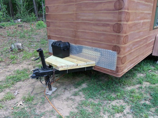

I need to do the roof on my CTC as well. It has "shingles" Painted on by the previous owner.. but I'd like to know if you can have the Kool Seal tinted some brown color instead of the white or galvanized look I hear about.
@ Steve_Cox, does yours have that blue tint look that you said you used?
I wonder how long it will really last on the camper whether it's Cool Seal or that elastomeric silicone??

Wolfscout wrote:I need to do the roof on my CTC as well. It has "shingles" Painted on
That is by far the coolest looking trailer. A true cabin on wheels... :thumbsup:

Postby Wolfscout » Sat Jul 23, 2011 4:07 pm
Thanks. I wish I could keep the previous owner's shingle look If I redo the roof.

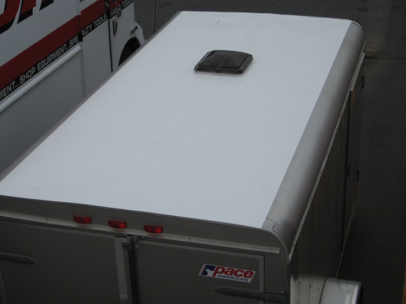

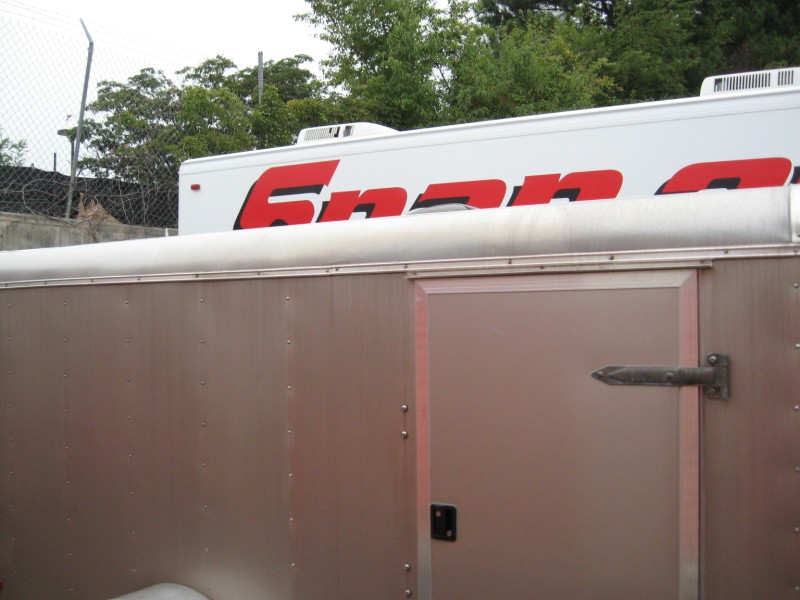

Postby Trackstriper » Sat Jul 23, 2011 7:25 pm
Wolfscout wrote:Thanks. I wish I could keep the previous owner's shingle look If I redo the roof.
This might work on your terrific log trailer, it's too cool.
I painted the roof on my 6x12 with white paint. I did do what Engineer Guy mentioned and used the 2" blue tape to mask an edge along the rounded edge of the trailer...used a string line for alignment. From normal eye height you can't see the white paint, only from above. It gets perhaps 85-90% of the surface covered, nearly all of the horizontal metal. The white paint did a great job in reducing the heat gain. You can really feel the difference between the painted and unpainted. Why not paint the whole thing? Stealth for my purposes, you could keep the visible shingles.
I talked with my local Sherwin-William paint store regarding paint types. I did purchase a gallon of their oil-based primer for galvanized metal. Then top coated with a high grade acrylic emulsion.... a direct to metal paint known as DTM. They like the idea of a paint that would flex well. I cleaned the roof well with a household detergent, let it dry and them primed. Top coat followed next day. I did use some of the DTM on the underside of the roof and it actually seemed to bond well, probably could have eliminated the primer. On a second trailer that I painted at the same time, in a similar fashion, I did have adhesion issues on the manufacturer's "high tech sealant" used to cover the seams and joints at the nose cap. I probably should have abraded this area with a ScotchBrite pad. The Snap On truck in the background is my storage unit neighbor.
