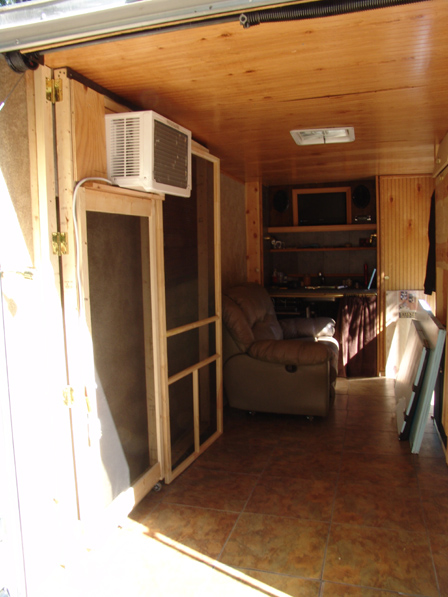

Xtremespeed wrote:Ok, so I need to connect the ground on the incoming line to the breaker box as well as the frame of the trailer, and the neutral and ground are not tied together anywhere correct?
capt4903 wrote:If your frame is bonded to the 120v electrical service, then the circuit breakers will trip, de-energizing the circuit if the "hot" wire comes in contact with the framework....
If the trailer tongue jack is setting on a block of wood and the trailer on its rubber tires, it is insulated from the ground....if the frame is not bonded to ground and the "hot" makes contact, you become the path to ground when you touch the skin or frame while standing outside... I seen it happen on a construction job-trailer firsthand....no electocution but the tingle was enough to almost make me wet myself.....
