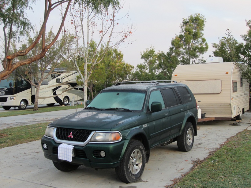

My 2000 Mitsi Montero has a 6 Banger rated initially at ~175 HP or so. It has ~210k Miles on it, and does just fine dragging my 15' Play-Mor TTT around. Guesstimate towing weight is 4k lbs., tops. It's rated at 5k lbs, Towing.
I let the Tranny Gears do the work, both up- and down-Grade. Redline Tach is 6,200 RPM from memory, but I max it out at around 4,000. A howling Headwind around Palm Springs dropped my mileage one Trip from ~24 MPG to ~9 MPG, but we got by. I have an oversize Tranny Cooler and adjustable Airbag Shocks inside the rear Coil Springs.
I pull over a lot, but I do that even when not Towing. As the old Bumper Sticker says: 'Easy Does It'.

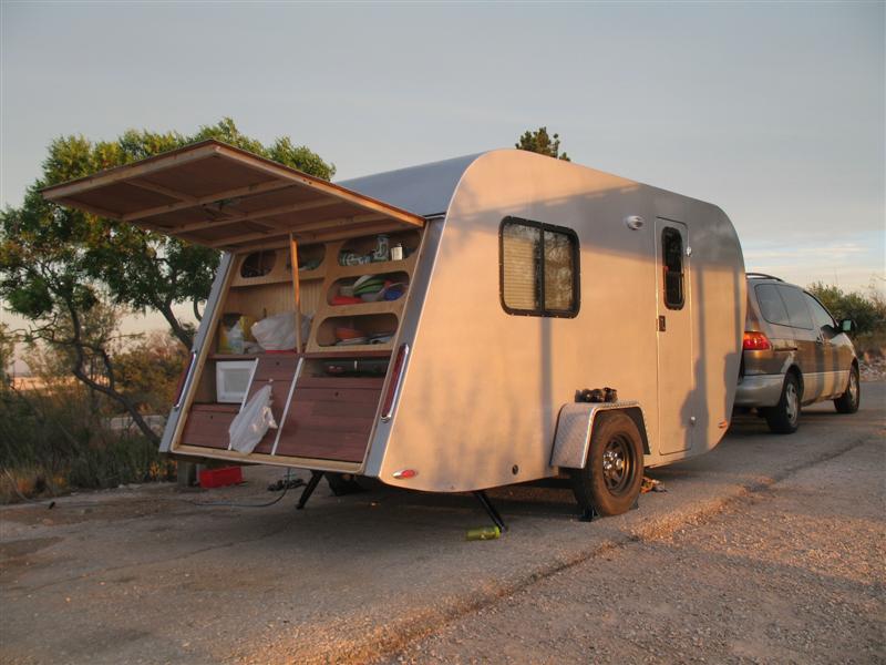

I towed a camper similar to yours in size (6'x13') with my Sienna V6 (HP - around 200 and torque around 200 ft/lbs)
My fuel economy dropped to around 15mpg from around 24mpg. Head winds and climbing up Mt Whitney to Whitney portal campground have a detrimental effect on fuel econ.
The danger is not in the pulling, though; it is in the stopping or slowing.
On the plus side, for the most part the wind resistance of the trailer works as a brake when descending hills and unless you are descending Mt. Whitney the lack of brakes on your trailer should not be a problem. In my case even when locked in first gear I was forced to periodically pull off to let my brakes cool descending Whitney. Brakes can only take so much heat before they begin to feel like ice.
