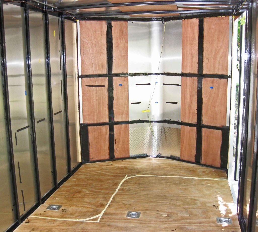

Recently purchased a lightly used 2011 Haulmark CT. The original owner bought it November 2011. When I removed the plywood paneling to insulate, I found the steel supports covered with surface rust. Didn't like that... especially since I live and camp at the beach. :NC
I took a wire wheel to the rust and painted the supports with POR-15, based on product reviews: http://www.por15.com/
Found the best price on eBay. Now I'm back on the insulation project. :twisted:
