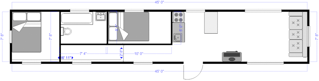

Let me first explain my plan:
I bought 16 acres of vacant land on which I would like to park, permanently, a 45ft converted cargo trailer which will serve like a cabin. It is 45ft long by 102" wide and inside it is 101" wide by 108" tall. Because I do not intend to move this giant around - my building plan is a bit different.
My plan is in no shape or form final and is based on many assumptions so please chime in with ANY remarks or suggestions as well as corrections:
General floor plan: I will make two bedrooms, bathroom with tub, and an open kitchen and living room as you can see from the image layout:

Hi Cargoconvert2,
Welcome to the forum ! They've a lot of good ideas here in general
and in the CT section too.
One suggestion I'd like to give for consideration, is to look at some
floorplans of 8-wide house trailers - mobile homes of the 1940s-1950s-early1960s.
The sizes are close to yours and you could get some ideas for efficient use
of space. Utilizing built-in furniture and storage as they did could make
your unit more comfortable and easier to live in. E.g. a couple of Murphy
beds could give you more daytime room with fold-down standard beds
for sleeping. Built-in cabinets, dressers and closets can be done economically
and efficiently. Unless you are going for heavy insulation [foams would be the
best r-values per thickness] you may want to rethink using 2x4 framing. Smaller
dimensions would work and save some precious inches of space - especially width
Your trailer as is already has sufficient structure. Just frame around any openings
you make and use enough other framing as needed for attaching interior finishings
and fittings.

Postby capy235 » Sun Oct 28, 2012 12:37 pm
CC2
Your proposed floor plan looks much like the 8 x 45 mobile home my parents had when I was a kid. The only difference was the middle bedroom was a built in twin and it had a built in dresser, closet, and I think the wall furnce opposite the bed. For your back bedroom suggest turning bed 90 degrees to make it easier to make the bed.
A vapor barrior would be on the inside of the wood studs not between wood and alum.
Most cargo trailers, by the time they are sold for non trucking use are pretty shot. Use caution when purchasing. Often the cost of an older mobile is much more advantageous. But I sure like the idea of the conversions. Our military has been converting ocean cargo containers for years for housing and there are several web sites devoted to that. Once you add a roff and exterior siding it again raises the why not just build a trailer from the ground up. Lots of frames from torn down mobile homes available for the price of the scrap steel.
