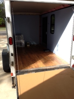

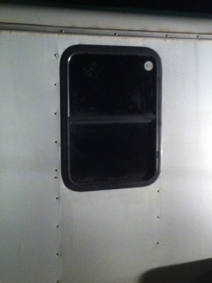

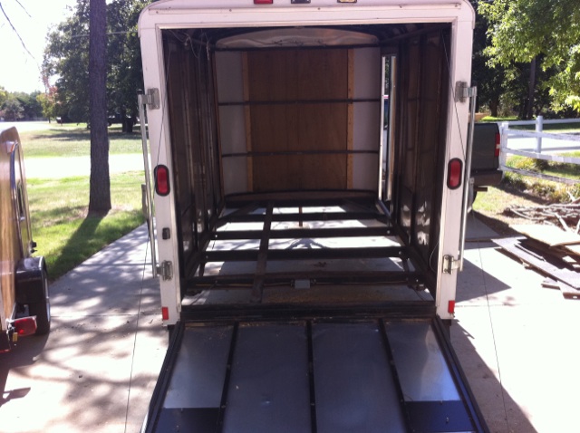

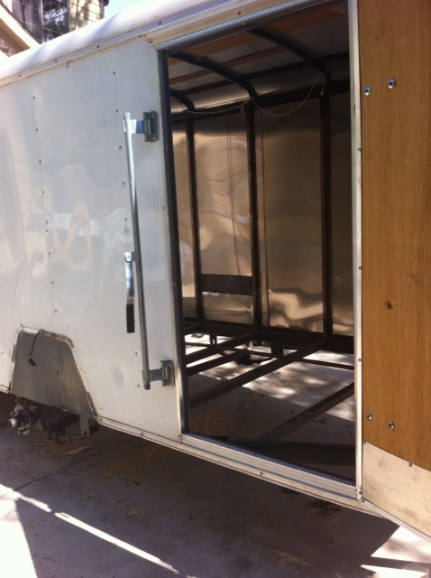

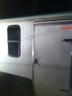

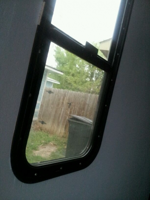

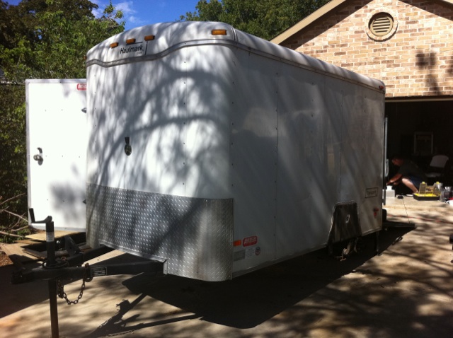

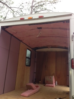

Postby WildTexan » Thu Apr 11, 2013 1:05 pm

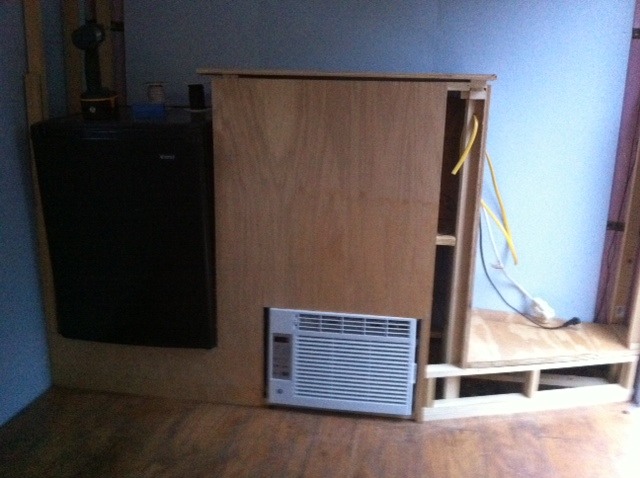

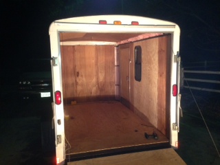

Well, I knew it would happen one day, and on October 5th it did. The teardrop wll no longer be enough for my growing family. :cry: So, without much hesitation I started right in on a CT conversion to make room for the new little guy. I stripped a trailer I already had down to the bones. New floor, insulation, paneling, and little paint, a couple windows, a laminate floor, and now about to start the cabinets. She's coming together pretty nicely. Better hurry, first trip is over Memorial Day. Here a few pics of where she stands so far.

Re: 6x10 Baby Hauler

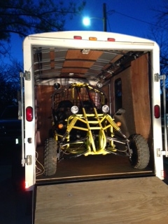

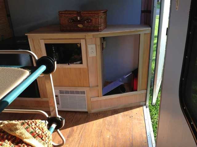

Postby WildTexan » Mon Jun 24, 2013 9:00 pm

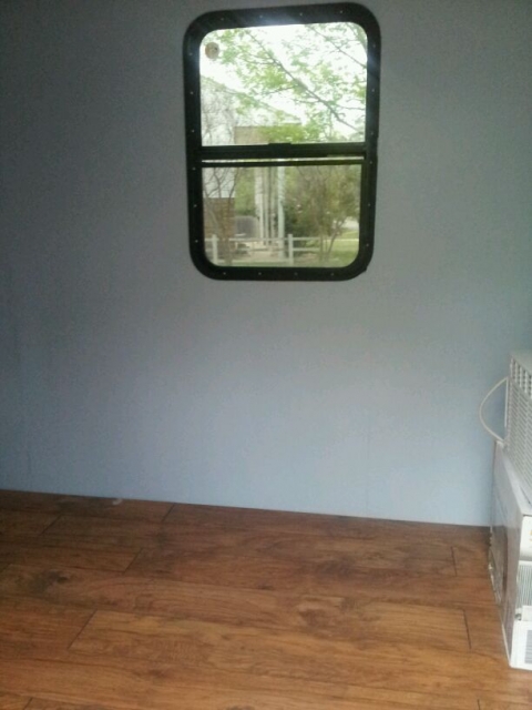

Finished with the conversion enough to go camping for the summer. Here are a few pics. Still working on little Elam's sleeping arrangement.

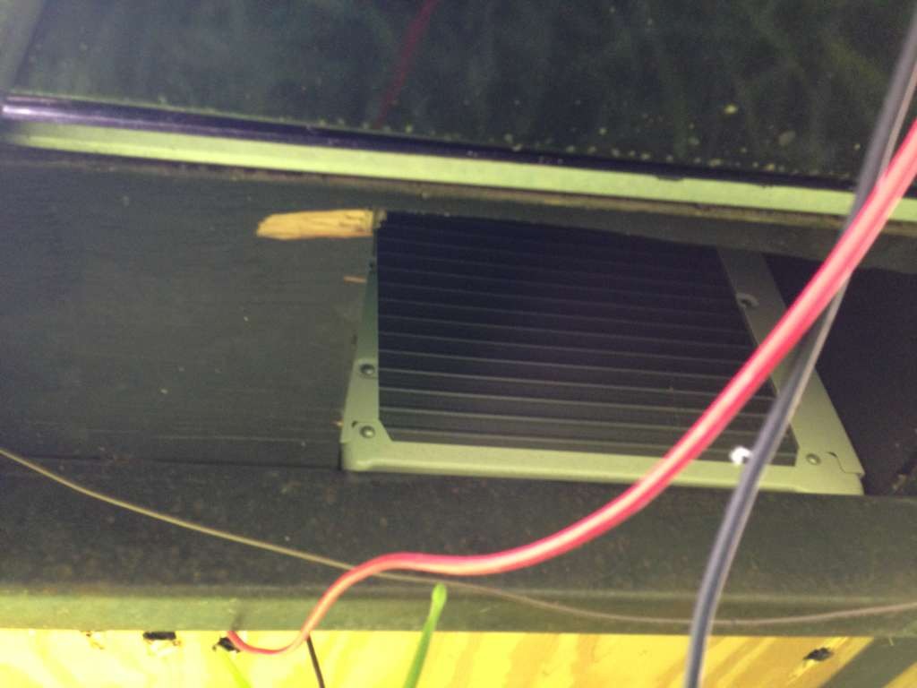

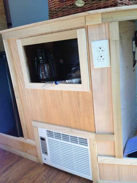

I would like to learn more about your inside AC install. That would work perfectly for my current project:

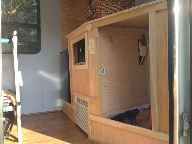

Postby WildTexan » Thu Jun 27, 2013 8:40 am
I'm not very diligent about taking pics during a build so I'll try to explain the best I can.

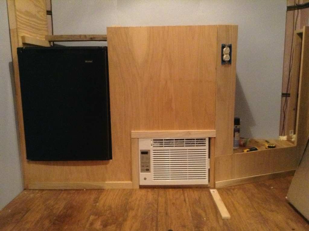

I first laid out my footprint for my cabinet with 1x2 poplar and screwed it to the floor. I found the spot I wanted for the ac and cut the exhaust hole directly behind it. I have 2 a/c techs in my family, so after they ran some figures to see what type if air flow I needed we drilled the needed amount of 1in holes through the floor. I believe there are 113 holes on either side of the unit. All of this is inside the cabinet footprint. We made a wood duct to put over the exhaust cut out. The unit itself is secured by pieces of poplar all the way around. Inside the footprint we sprayed the floor, poplar, and 6 inches up the walls with that rubber sealant in a can. We built a footer for the cabinets that acts like an intake duct. All the seams are sealed with foam, and silicone. We drilled new drain holes in the unit. Condensation runs out these holes and into the rubber sealant on the floor. It then travels to one of the 113 intake hopes we drilled to drain out of the trailer.

Postby WildTexan » Thu Jun 27, 2013 8:41 am
The exhaust
