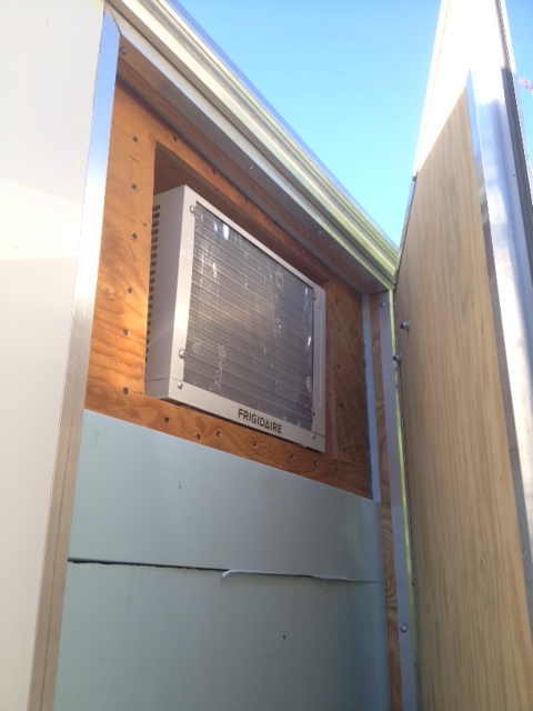

Just to test the concept, I made a small box with 2" around the ac & attached it to the door frame....
then you just open the side door 3-4" when you need ac,
frame can be removed easily anytime or during winter months ...
works great

Does one have to leave circulation to the sides from outside air for this concept to work or is just having the back end of the AC exposed all that is needed. I just assumed the sides needed to be exposed to the outside because that is the way one sees them hanging out of windows in houses.
Bob
lrrowe
Posts: 3285
Images: 439
Location: SW Virigina
Re: Finalizing purchase
Postby OverTheTopCargoTrailer » Mon Aug 12, 2013 2:46 pm
YES
you need a 2-3" gap on both sides and the top as thats were the vents are to suck in the air.
it may also suck in some hot exhaust air, but seams to work ok :D :D
