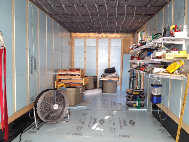

Postby OverTheTopCargoTrailer » Tue Aug 13, 2013 9:59 am
Oh finally after preaching to the choir forever almost now,
or at least until i'm blue in the face
someone is putting in a second layer of insulation - to prevent the thermal bridging
don't forget the floor & the doors 8) 8)
:applause: :applause: :applause: :applause: :applause: :applause: :applause: :applause:
Congrats JJvw :beer: :beer: :beer:
all alum for $5,600 ...im gonna let you negotiate my next trailer,
did you get them to throw in Dexter torsion axels & never adjust breaks too ?
what a great deal....cant wait to go Arctic camping with you

Thermal Bridging ???? I did not know what that was so I went to Wikipedia (I know, not always the best source of info) and got this:
"A thermal bridge, also called a cold bridge,[1] is a fundamental of heat transfer where a penetration of the insulation layer by a highly conductive or noninsulating material takes place in the separation between the interior (or conditioned space) and exterior environments of a building assembly (also known as the building enclosure, building envelope, or thermal envelope).[2]
Thermal bridging is created when materials that are poor thermal insulators come into contact, allowing heat to flow through the path of least thermal resistance (R-value; or a material's effectiveness in resisting the conduction of heat) created, although nearby layers of material separated by airspace allow little heat transfer.[3]
Insulation around a bridge is of little help in preventing heat loss or gain due to thermal bridging; the bridging has to be eliminated, rebuilt with a reduced cross-section or with materials that have better insulating properties, or with a section of material with low thermal conductivity installed between metal components to retard the passage of heat through a wall or window assembly, called a thermal break."
I take this away from the description --that even if you insulate between the metal posts , cold and heat will radiant thru them and undermine one's insulating work.
Maybe this is why I might think of a 7x12 unit instead of a 6x12 so I can double insulate and still have enough width in the trailer for what I want to use it for.

I learned about thermal bridging soon after insulating my trailer and having the walls back up and already carpeted. It was no problem figuring out where each metal stud was located just from feeling the heat coming through the 3/8 plywood. Not a problem now with my 13.5k roof A/C unit but when I was trying to use my original 12.5k portable it could not begin to keep up because of this. I have not noticed this problem in reverse in cold weather though. A small 1500 watt electric heater will keep my trailer toasty warm down into the 20's and usually just running on low.

My wife asked why I was putting more insulation on when she touched the aluminum stud and quickly removed her hand. It was only 78 but that side was in full sunlight. I got some plastic xmas tree fasteners on order to bond the outer layers. I don't want a corrosion problem with screws in aluminum.
