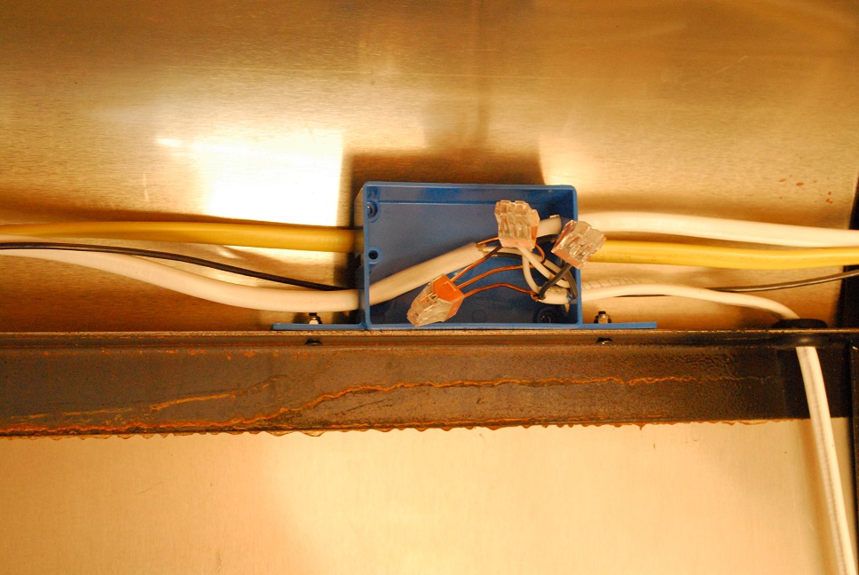

Postby orcadigital » Wed Oct 23, 2013 5:26 pm
lrrowe wrote:The Wago connectors look neat. I have never seen them before. I am going to order some to see how well they work for me. Thank you for the lead.
Bob
I bought an assortment online, but found them at Lowe's as well in small package quantities. I did not need lots, and picked up some small packs of various terminal counts (2, 3, 4, 6 etc). Below is a picture of them in use. Made for a very clean install and so very easy. Way better then the luck i had with twist style.

Postby roadinspector » Wed Oct 23, 2013 9:06 pm
I sure wish I had known of these before! I've never had problems with twist locks but that look like it would be lots easier and cleaner.

Re: interior wiring - romex vs. individal runs
Postby capt4903 » Sun Oct 27, 2013 11:44 am
Wago's are fine and dandy for the residential trade who are all about slamming out cookie cutter homes in the shortest time possible...., but in the commercial environment we always twist the wires and use wire nuts...also wires are wrapped around the screws for full contact....if there was a chance of vibration, I always wrapped a few layers of tape around the nut....my main point is, with a "push in" type connection there is only a very small contact area between the wire surface and the tab in the Wago or "back stap" receptacles....that leads to resistance, which leads to over heating of the joint and eventually failure....replaced a lot of the cheap box store recepts for friends which have overheated and failed.....been in the electrical trade since 1998 as an I.B.E.W. trained master electrician.....I cringe when I see some of the photos posted on this website....
just my opinion.....
p.s. almost all the r.v.'s built are wired with romex...just use bushings when it passes through metal studs......

Postby prodart » Sun Oct 27, 2013 3:11 pm
capt4903 wrote:Wago's are fine and dandy for the residential trade who are all about slamming out cookie cutter homes in the shortest time possible...., but in the commercial environment we always twist the wires and use wire nuts...also wires are wrapped around the screws for full contact....if there was a chance of vibration, I always wrapped a few layers of tape around the nut....my main point is, with a "push in" type connection there is only a very small contact area between the wire surface and the tab in the Wago or "back stap" receptacles....that leads to resistance, which leads to over heating of the joint and eventually failure....replaced a lot of the cheap box store recepts for friends which have overheated and failed.....been in the electrical trade since 1998 as an I.B.E.W. trained master electrician.....I cringe when I see some of the photos posted on this website....
:applause: thank you for being the source of reason, I was trying to figure out how to explain the shortcomings of the wago connectors
