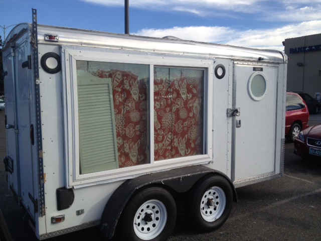

Postby OverTheTopCargoTrailer » Tue Nov 26, 2013 1:20 pm
A Big RV window.JPG (120.29 KiB) Viewed 1028 times
I say GO FOR BROKE !!!!
may as well have the best view in the trailer Park :thumbsup: :thumbsup: :thumbsup:
