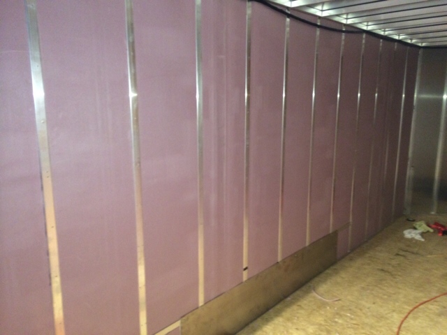

Ready to get to work. Got a Stealth 7x16 aluminum. Using it for a RZR and to camp.
Added insulation to the walls. Ceiling is next. Need to get windows and then maybe a roof vent. Not sure about that yet, would windows be enough.

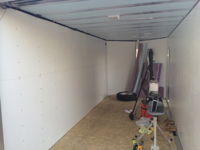

Postby TFBruin » Tue Jul 01, 2014 12:05 am
Walls painted and reinstalled. What is a good roof vent? Seems like the prices really vary. Anything special to look for?

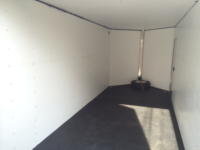

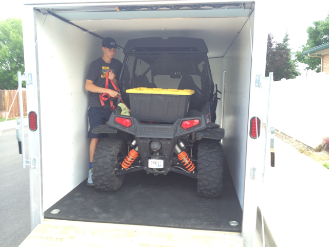

Postby TFBruin » Thu Jul 03, 2014 6:26 pm
Ceiling panels bought painted and installed. Floor installed. RZR 4 ready for first outing in new home. Long way still to go.
