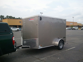

Postby willfish4fud » Fri Jul 04, 2014 12:13 am
6x10 on the way home

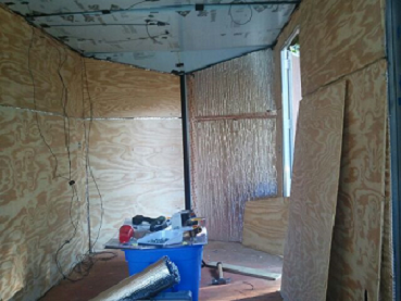

Postby willfish4fud » Fri Jul 04, 2014 12:25 am
Blue foam board and foil bubble wrap are in and ply is back on

Postby OverTheTopCargoTrailer » Fri Jul 04, 2014 10:09 am
Welcome aboard
I'm glad to see that the Dow Blue board is finally catching on here,
It's hands down number 1 quality vs the pink or white.
Don't forget to put some on the floor & doors too
Cheers OTTCT

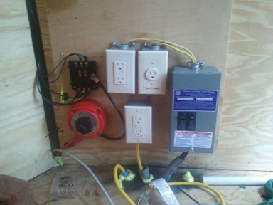

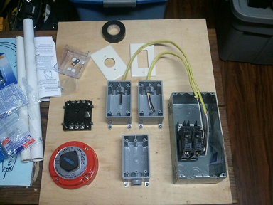

I live in the woods and internet has been hard to come by lately. I finished insulating and then built the electrical panel on a piece of 3/4 ply in my living room. I have a 12v system including a battery switch that allows switching between two batteries or paralleling them. I ran a separate line from the Honda 2000 generator to a dedicated outlet (bottom one). Then shore power runs through breaker box and has one dedicated circuit for 5,000 btu AC and another for miscellaneous. All lights are 12v LED. Air cond can be run by shore power or generator simply by unplugging from one and plugging into the other. Solar panels are not installed yet but are a future add.

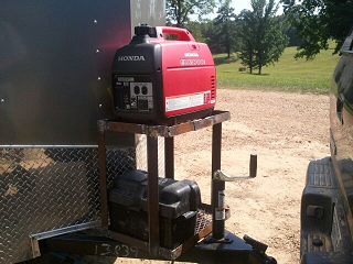

Postby willfish4fud » Sat Jul 12, 2014 11:01 pm
heres panel installed on interior front wall. also made and installed a rack for 2 batteries and generator

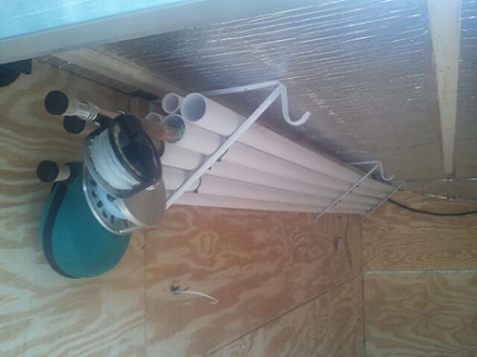

Also got part of flyrod racks made n installed. These will be closed in when ceiling is done and will hide tubes. Also serves as a chase for running wires front to rear

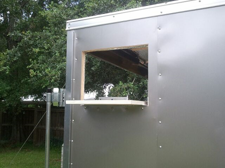

cutout for AC is done and shelf made of starboard installed

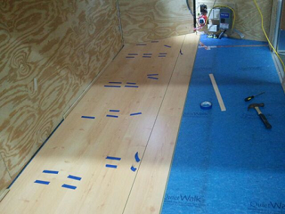

A friend gave me some laminate flooring...went in very easy once I got the hang of it
