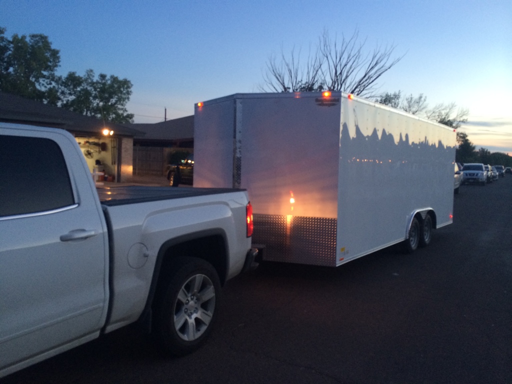

Thanks for all the welcomes and advice guys. Here is a pic of the trailer.
Keep in mind this is my first time doing anything like this. I wish I would have got the trailer with windows but didn't maybe I can add a few?
As far as power I planned on doing all ac wiring because I don't get how to do the dc stuff. Only thing I would maybe run dc on would be lights. I will be able to plug into 30 amp service where I go. I also have a generator that is 7500 watt but I will prob get a smaller one to carry with me this ones diesel.
I plan to do all my wiring and insulation first, then later add the restroom. Is it possible to not use holding tanks and have waste drain straight out?
The ac I am getting is coleman 13,500 and claims to pull 14.9 amps cooling and 16 heating.
Other things I plan to add will be mini fridge, microwave, tv and few lights and plugs.
