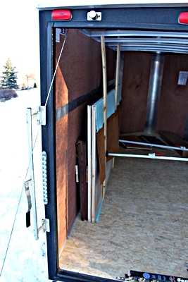

I have some unique problems I am trying to solve and would appreciate some ideas. Inside the left side along the back wall will need to be a stable and secure place for the backwall for my set for a stage play I do. It is important that it lay tight against the wall and not jostle around. The gentleman who designed it suggested a few small holes in the side wall and then put "s" hooks into the holes and strap tight. I thought about a hinge system using hinge pins that release when the set is not in the trailer. I looked at E-channel but don't like the way it sticks out from the trailer side wall and could potentially mar the set wall. I would enjoy any suggestions. The current system will work until I start the build-out this spring

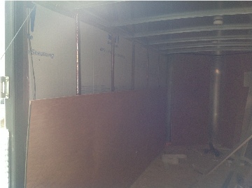

Here is the backwall that is in the trailer once it is "set-up"
Looking forward to everyone's ideas and hopefully meeting you on the road.

Postby abqlloyd » Sat Jan 17, 2015 12:21 pm
Get some recessed floor hooks for trucks, mortise into the wall, and then strap it down.

Postby abqlloyd » Sat Jan 17, 2015 12:24 pm
Here's one style. You might be able to anchor to the frame and still have flush with plywood wall depending on trim.

Postby teampiney » Sat Jan 17, 2015 2:23 pm
You could use E-track singles to either side. That way could still be strapped flat against wall.

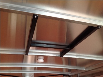

Ceiling vent bracket.JPG (40.18 KiB) Viewed 3161 times
Had the neighbor weld up the frame for my ceiling vent. Since it has the "ceiling fan" function decided to put it smack dab in the middle of the trailer. Not sure if that is good or not. Any suggestions before I cut the hole would be appreciated. Easy enough to move the bracket now before the cut!

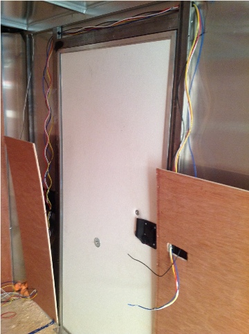

door switch.JPG (71.51 KiB) Viewed 3151 times
Wiring is started. Going to feed to a Power Dynamics power center at the front of the cabinetry. Four switches at the door will control a porch light, and ceiling lights. I will also use small self contained battery puck lights that I was using this winter when I would load at night. I probably went overboard on the number of lights I bought, but I do a lot of loading later in the evening getting ready for a show or after one. Still wondering if I need a flood light on the outside too. Anyone have experience with those? Is there a lot of glare that gets into you eyes trying to load?

Postby lrrowe » Sun Mar 08, 2015 7:26 pm
I placed mine about where the side door is lengthwise. I left room in the remaining space for a second one to be half way down the remaining roof should I ever want to add one. I really do not think I will add it though as cracking opening a window should give me a cross breeze (up breeze).
