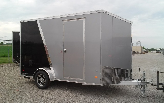

American Hauler
7x12x7-V-nose All Aluminum.
About 1550LBS. single axle with brakes.

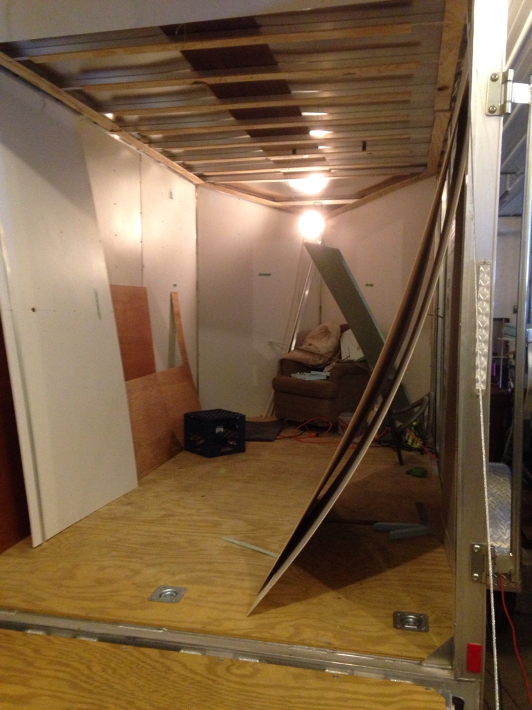

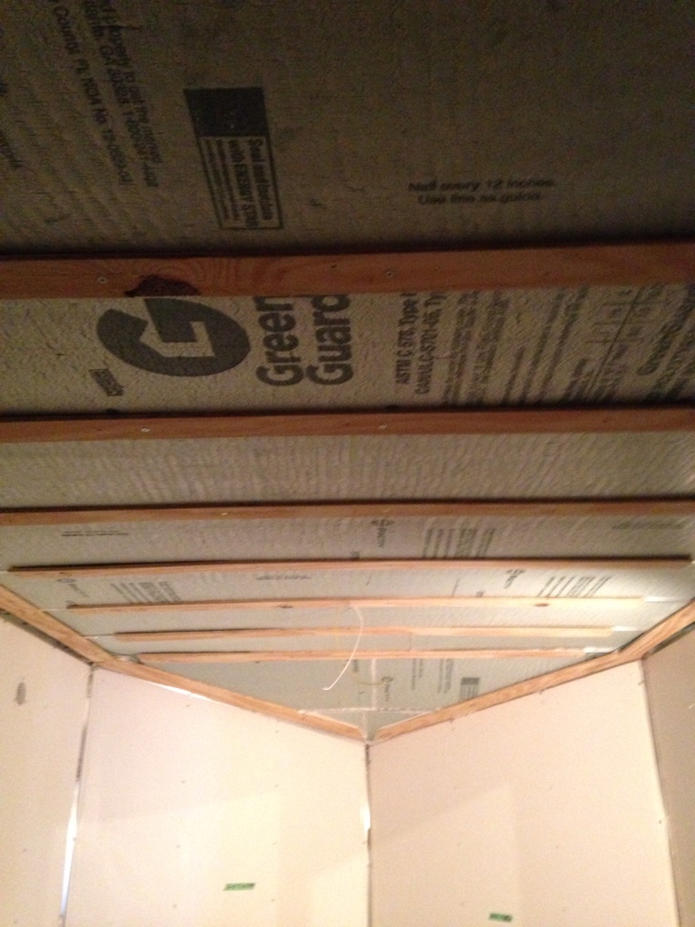

It will be a slow build, I have very limited income. It will be a cycle, kayak, camper, yet still be usable for cargo hauling. It was purchased for my use, its not quite what I wanted but its what I can use. I want/need shower, toilet bed that raises to ceiling. I have torn down around 25 trailers and not much was reuses able. I'm getting a pick-up camper to dispose of and hope to be able to use some of it. I've started the insulation walls and ceiling are already done, under floor is next. I'm waiting for my friend to drop more off.

Padilen, well you did fine getting this picture up. Nice trailer. I like the two tone and considered that myself, but needed to keep the cost down.

I got the rest of my insulation yesterday.

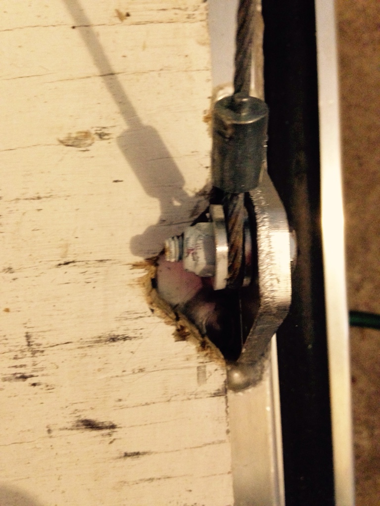

Today I managed to get the plywood off the ramp door. By carefully drilling and chiseling wood away. The bolt holding the cable was hindering limiting wood. I hope to get started on cutting the instillation tomorrow.
Warning to those that don't know. The springs on the ramp door are set to lift the weight of door with the wood on it so be careful. I managed by myself but would recommend 2 people.

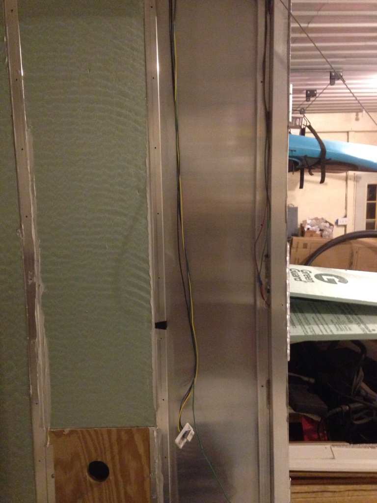

Worked on insulation of the ramp. 2 sections left where the latches go. I don't like the factories system of supporting them.
I didn't insulate a small section of side panels. I didn't want to remove door opening trim. But it's been bothering me. So I used a hair dryer and heated up the glue. It did bend but I got them off. I'm going to do something with the wiring before I insulate.

Flipped over ramp plywood and coated back side with a waterproofing.
This is how I eased plywood removal on ramp-without removing cables.

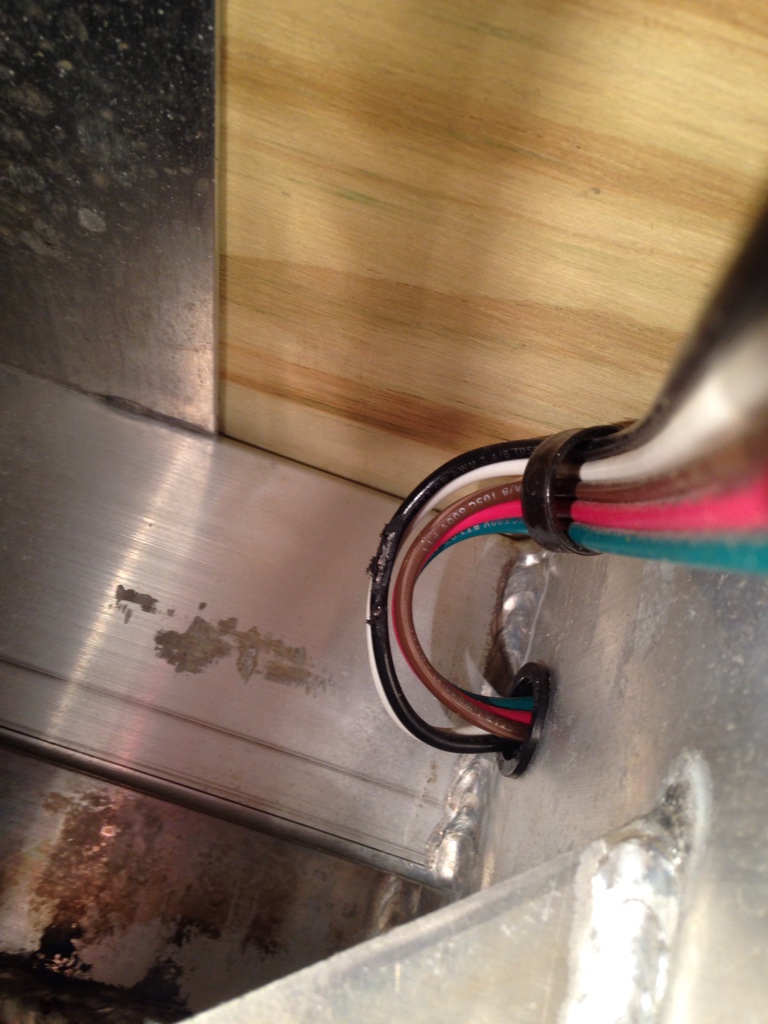

Found this under trailer- bare wire.

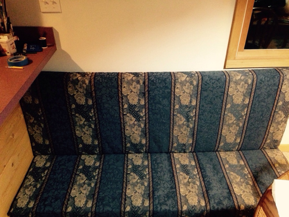

Cushions are sewn ! Another neighbor to the rescue with a loaner sewing machine.

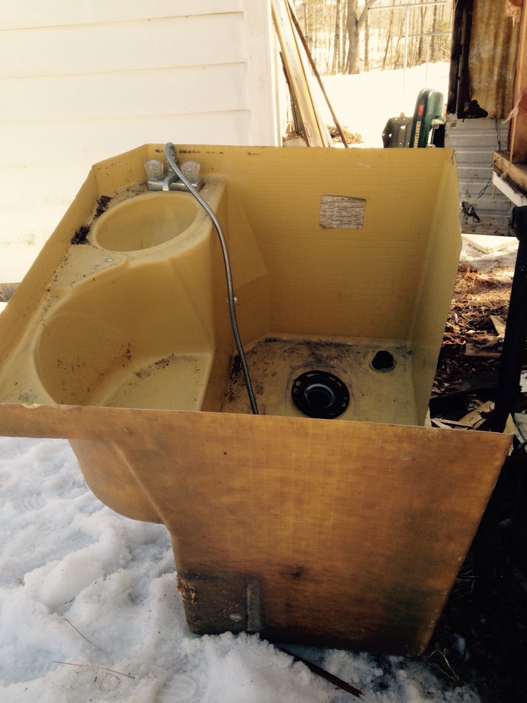

I got a used single sink. I removed a toilet shower combo from a pick-up camper and the furnace and hot water heater. I couldn't fit toilet shower in my Jeep so I'll have to pick it up later.

Ordered a water tank, the one from pick-up camper was broke where fittings connect. The one from TAZ had holes.. Also ordered a faucet for sink.
I'm rethinking using any of my scrapped parts. Not worth having a failure in my CT.
I'm disappointed, a lot of work for nothing!
