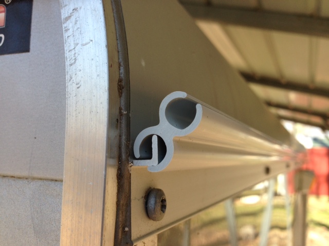

I was wanting to attach a awning to my cargo/camper without drilling holes or breaking the seal in the roof cap. I tried some of the figure of 8 awning channel and it seems like it is going to work OK. My trailer is a Wells Cargo and it has a small gutter rail of about 1/4 inch. The figure 8 slide right over it and I can slide my awning in the opposite side open channel. I haven't got to camp test it out yet but the channel attached to gutter seems plenty solid to me. I'm just sewing a small diameter rope in a light tarp to slide into the channel. I have under 18 bucks in the channel delivered so thought I would throw this out there in case anyone is considering a cheap awning option for their trailer.

Terrible idea if you want to keep that gutter. Wind or ran load will snap that right off.

You could be right, but I don't think it will. It sure seems a lot stronger than what I have used in the past that worked fairly well. This is only a 5x8 trailer and if the tarp is angled and put up right I'm not worried about water at all. Wind on the other hand can do some strange things that's for sure. I wouldn't bet on strong enough winds doing a lot of things. If I think the wind is going to be strong enough to rip things off I will take it off like I would any other awning. I'll tell you what tnriverluver, if it gets torn off I will come on here and tell you it did, and I will thank you for giving me the advanced warning. :beer:

Why not just take off the drip rail and screw an awning rail there they make one that basically acts as a drip rail too just google awning rail all kinds of configurations good luck

What you want is a sail extrusion.its like what you've got but single sided with varying leg configurations to rivet to your trailer

If the figure 8 doesn't work like I want my plan B is the awning rail that bolts on. I was trying to get a simple on and off awning and not breaking the seal it has now on the cap. Nice to have a back up plan though. Thanks for the replies. :thumbsup:
