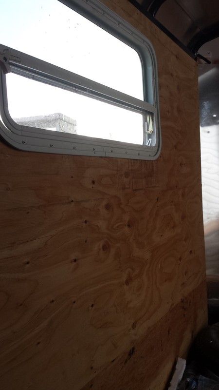

Hi all=) excited to be here! great info i see here so far. After owning many trialers, 2-40' toy haulers, 1-25' bumper pull im trying to run leaner and meaner now adays and stop spending ever dime i make so ive decided to go this route for a couple years :D :D Recently i bought this 6x12 enclosed (4 budget reasons) paid $2300 for a 2014 and plan on doing the follwoing:
What ive done so far:
-put in a 30x20 window, reinforced the structure.

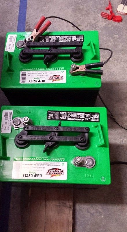

-installed 2 6V 250AMP hour batteries

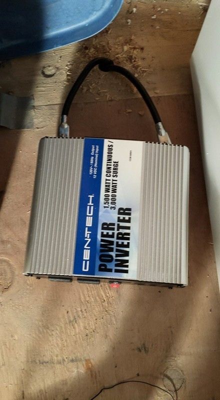

-installed 1500 watt inverter

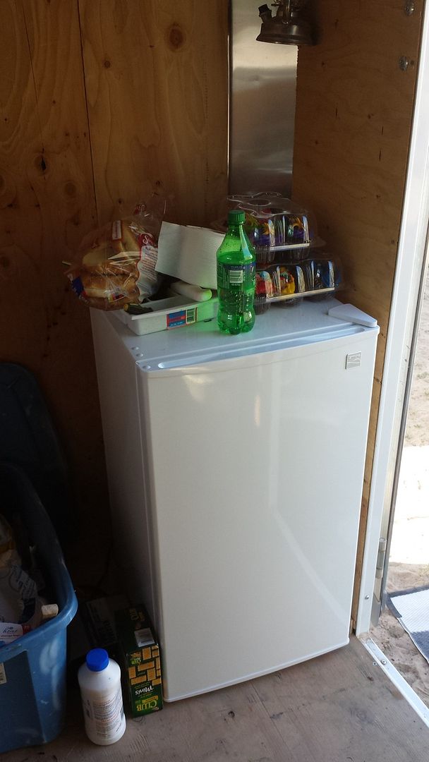

-installed 3.3 cu ft fridge

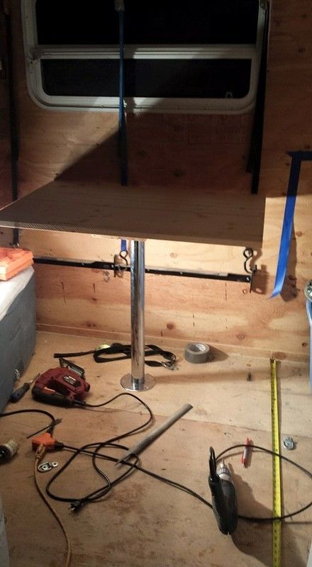

-installed a 30x30 table

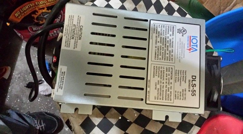

Postby desertrat222 » Tue Apr 07, 2015 2:46 pm
Pretty excited just picked up the following today, ill have my work cut out for me the next while!
▬ 1500 watt inverter
▬ 55 amp converter
▬ 2-250 amp hour 6V batteries
▬ single LP tank bracket, regulator and some copper tubing
▬ water inlet connection
▬ shore power connection
▬ and stuff to put up 2 small tables
desertrat222

Postby desertrat222 » Thu Apr 09, 2015 9:58 am
Got our little table installed last night and a temp fridge for the weekend. picked up some 250 Amp hour 6V batteries, converter and inverter. ill work on my wiring and cabinets next week.

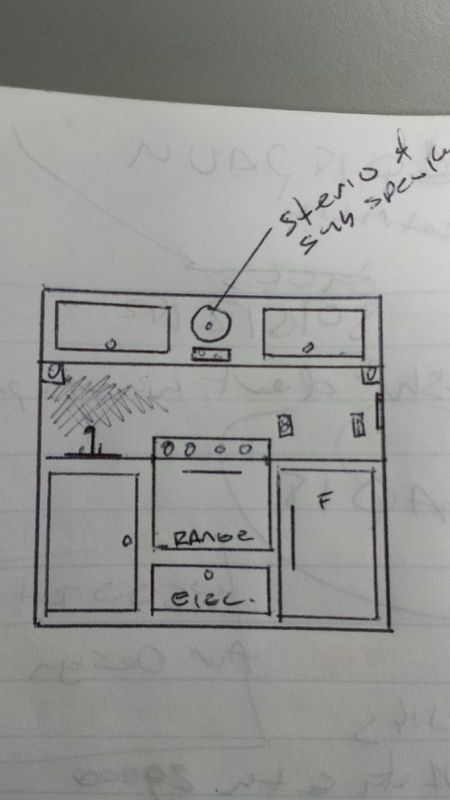

Postby desertrat222 » Fri Apr 10, 2015 10:52 am
My conceptual cabinet drawing =) It will include 3 cabinets, 1 small sink, LP Oven/stove, 120v 3.3 sq ft fridge, elec compartment, stereo with a sub and 2 box speakers. i'm no wood worker so a little nervous about this next step but it should turn out pretty good i think.

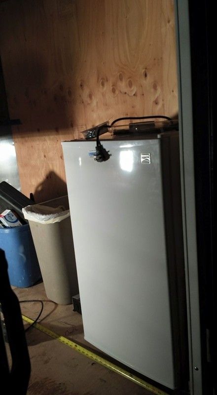

Postby desertrat222 » Sun Apr 12, 2015 10:10 pm
Yeah she passed the test. Got my 2 batteries installed and my 1400 watt inverter and i had an ice cold fridge for 2.5 days :D

Postby desertrat222 » Sun Apr 12, 2015 10:11 pm
Table

Postby hankaye » Mon Apr 13, 2015 10:49 am
desertrat222, Howdy;
Was your 2.5 day test of the fridge only using the fridge or did you use
some other electrical devises during the same time frame utilizing the
same system?
Curious mind syndrome asking.
hank
hankaye
Posts: 2567
Location: S.W. New Mexico
Re: Newbs Here 6x12 build toy hauler / glamper
Postby desertrat222 » Mon Apr 13, 2015 12:12 pm
I don't have anything else wired in at this point. Soon ill have 4 LED interior lights. Down the road a 400 CFM exhaust fan sucking air through some evap cooler media pads. Hopefully ill have 2-250 watt solar panels installed by then also.
