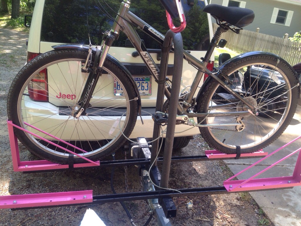

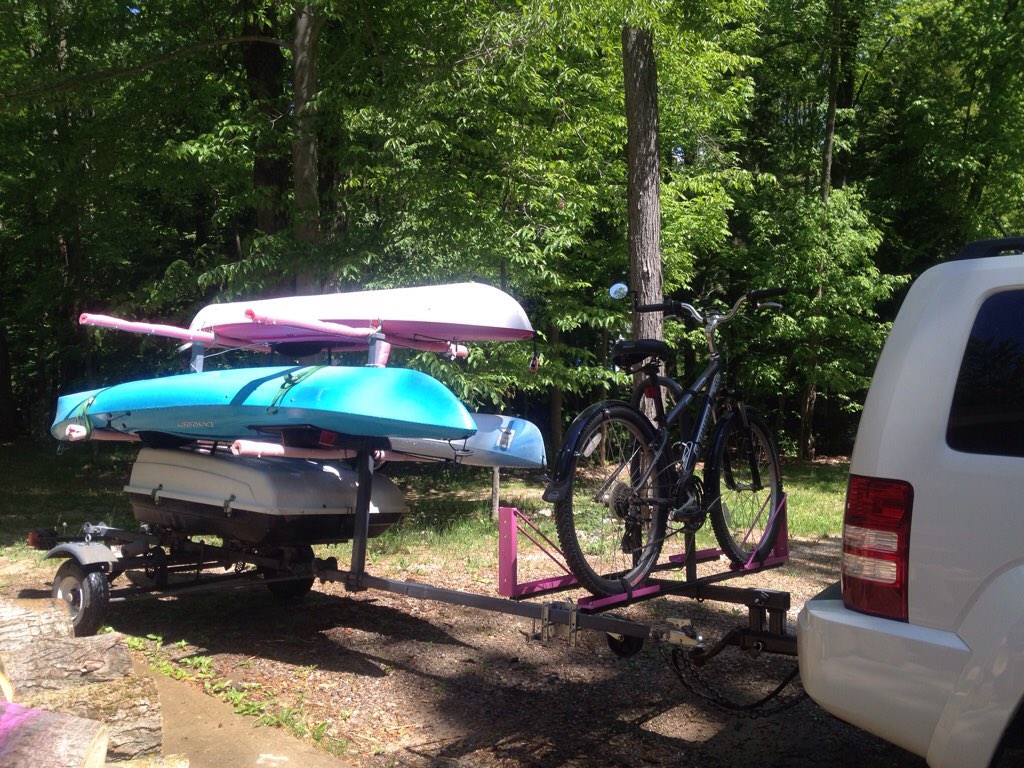

Dirt bike to me is a motorcycle, not a bicycle. I may be over cautious but again Id not place one on back of CT. But I could see a bicycle or 2 back there. Some use the cycle carriers (no trailer) and have had issues. That's the reason I wanted a CT conversion. But if determined here is the combo I referred to- with my bicycle and kayak trailer.

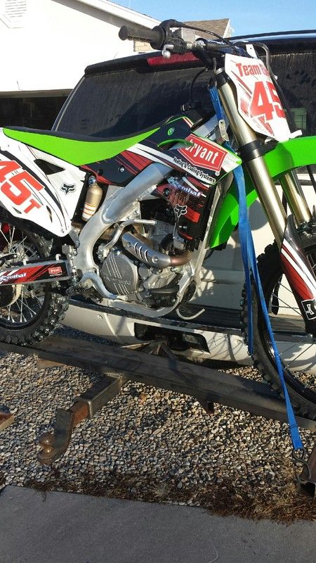

Buddy ill build you one of these for $300 local utah pick up only :D use the term "rear receiver" lightly lol :thinking:

Mine goes between your truck and your CTC if you look closely it has a receiver in the end. its plenty strong enough for a CTC. i use to use this type of extention with my 10.5' camper when i pulled a 20' trailer with my sandrail. i used the same extension and just did some fabricating. This is mine i have a 3 rail trailer but my 4 yr old just got a PW50 but i built it big enough to accommodate a large bike in case my boys ever want to bring a friend riding.
