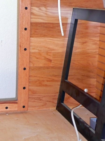

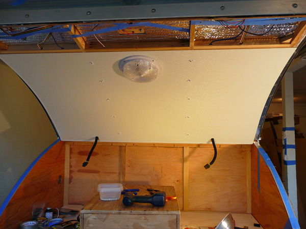

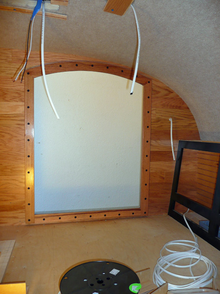

Instead of decorative screws, I used two different methods to dress up exposed screws.
To fasten my interior door jamb/surround I used black oxide oval screws with finish washers. Here's a link to the finish washers: https://www.fastenal.com/products/details/0149243. Here are a couple of pictures of the door surround:

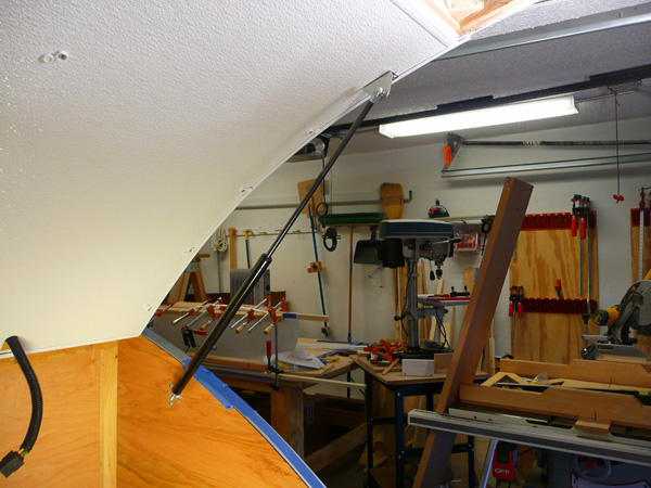

For the underside of hatch I used regular screws with plastic screw covers. (I hadn't snapped the covers over the screws yet.)

Tom, that does work for me. Thanks for your link and photos. I am not sure what I will do, but this is a very good start with my search.
