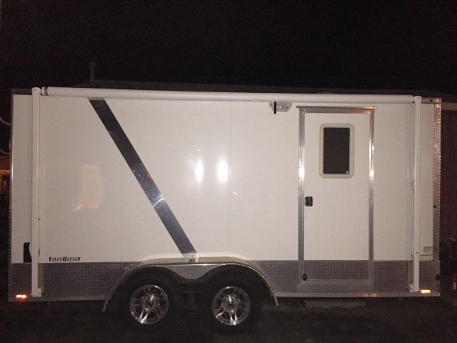

Postby ejfeicht » Tue Sep 01, 2015 7:55 am
Had the awning installed over the weekend and it came out great. Ended up having sufficient clearance without needing to lower the side light.

Postby CoventryKid » Tue Sep 01, 2015 10:01 pm
Looking good!!
I've been looking for an awning for our 16' CTC - similar to yours but with a round top.
I assume the lower mounting bracket is/can be attached directly to the trailer frame. But what about the upper? Is there enough "meat" to simply attach the upper bracket to the roof edge, or did your installer have to add blocking on the inside?

Postby ejfeicht » Tue Sep 01, 2015 11:20 pm
The RV Center indicated that they followed Forest Rivers recommendation for attachment into the upper and lower sections of 2" angle.
