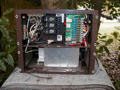

Postby dustboy » Tue Nov 03, 2015 10:27 pm
In the first photo those are standard Cutler-Hammer breakers as might be found in your home...your local home improvement store should have them or a comparable fit.

Postby Doublacola » Wed Nov 04, 2015 10:03 am
I'd sell this if you are interested. $50 + shipping

Re: Charger or converter?
Postby McDave » Wed Nov 04, 2015 11:30 am
@ Doublacola,
If that is a functional unit I'd be interested. What type/model is that ?
Postby Doublacola » Wed Nov 04, 2015 1:24 pm
McDave wrote:@ Doublacola,
McDave
It's a WFCO model FP-01 WF-8900 series
It came out of a 2011 Kz Sportsman 21' that a tree fell on 2yrs ago.
It was operating when I pulled it out.
If your still interested send me an address and I'll get shipping costs.
There's one on ebay identical to this one for $130
Thanks
