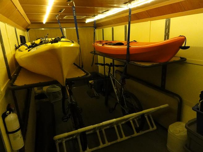

Postby NO David! » Tue Apr 19, 2016 7:49 am
I know this doesn't answer your question directly, but hopefully will show you a possible alternate solution. I really liked the fold outside the wall tent bed idea too until I saw the cost.
We wanted to fit 4 kids in our 7 x 16, here's how we did it:
Camping mode-
Hauling mode-
Some details in this thread:
http://www.tnttt.com/viewtopic.php?f=42&t=49766
