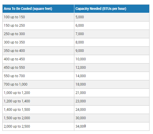

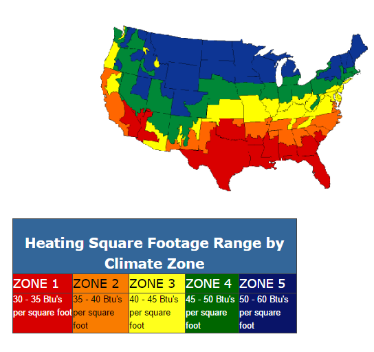

  • Here are two BTU-to-room sizing charts, one for heating and one for cooling requirements:
    Heating BTUs per square foot chart.PNG (68.28 KiB) Viewed 4808 times
    Energy Star BTU-TO-room size chart.PNG (27.77 KiB) Viewed 4808 times
  • As one can see, room (or trailer cabin) size dictates the size of the unit used, but these charts are for normal adequately-insulated homes, not most trailers and cargo conversions, where insulation may not be up to "home" standards. In my 4x8 plywood trailer's case, I opted for no insulation, feeling that I would be able to heat it or cool it to my climate range, without it. I can, using a 5k BTU LG window unit for cooling, and one (or two, if needed) Lasko My Heat personal heaters (200 watts each, or 682.4 BTUs each) for heating. I supplement the heaters with comforters and <20 degree sleeping bag, if ever needed (but not yet).

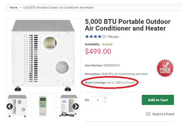

  • The Climate-Right webpage makes a claim to cool/heat? 1200 square feet of space, which probably isn't possible (even inside a Yeti cooler).

  • Your trailer is a 6x12, or 72 square feet floor plan, requiring a 5k BTU unit to cool, and about 3420 BTUs to heat (heating requirements of 42 BTUs per square foot-the average/middle ground spec from the chart above-). That would require a heater putting out/consuming 1003 watts per hour, to heat. Your needs can be met more cheaply, and better served by a simple 5k BTU window unit, and a standard 1500 watt electric heater (assuming the above climate range).YMMV

working on it wrote:The Climate-Right webpage makes a claim to cool/heat? 1200 square feet of space
Cubic ft... you got to divide :frustrated:
So, say the ceiling height is 6'... 1200/6=200 sq ft.. a stretch but possible...

Postby Socal Tom » Wed Mar 29, 2017 9:12 am
The Climate rite was designed for pets, so they probably assume less of a temp drop.
Whoops, I goofed. Maybe it's time to get a new eyeglass prescription...I could'a swore that....
