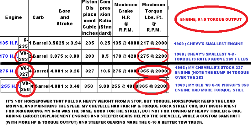

Postby working on it » Mon Apr 17, 2017 11:02 pm
  • I think this thread is beneficial to all who want bigger trailers, but also need to realize that bigger trailers need more capable tow vehicles. I've been known to overload my trailers, sometimes where the tow vehicle strains under the load, and the movements of the trailer dictated what the tow vehicle felt, as a result."Tail wagging the dog".
  • I had low budgets, and had to make do with what I had, until I could address the problems. Using progressively heavier trucks, with progressively stronger engines, and steeper gearing, made towing easier and safer. The addition of a Weight Distributing hitch, and sway control, made everything that much better. Eventually, I bought a truck better suited for towing my race car and heavy trailer, so now, having only a TTT to tow (no more racing for me), the tow truck's capabilities far exceed the tasks it faces, even with my now 2000 lb tiny 4x8.
  • I originally thought that horsepower was everything, since the old car advertisements bragged on it. But, racing, and even moreso, towing, educated me on torque being the prime mover to get a load rolling. At first, in dragracing, I focused on making more hp for the finish line, but moving my heavy street cars off the line, without enough "grunt", put me at a disadvantage oftentimes. So, I learned to give up a little hp, to gain torque, and did better. Gearing and traction are very important, too, but torque starts everything moving.
  • Back to towing, the same principles hold forth, where torque is still king, gearing is second, and weight and weight distribution are no small players. Old hands at towing warned me about too heavy a load, "tail vs dog" syndrome, and some mentioned a 80% rule-leaving 20% of your maximum vehicle+load rating as a safety factor-only tow at 80%. Others warned me about my trucks weighing much less than the total load, and that a WD hitch would help. I listened, learned, and use my WD on everything (I rely on it).
  • I read here about some smaller displacement engines being expected to haul larger trailers, because they are rated to tow the approximate weight, and have the hp numbers that should manage the feat, but their torque numbers belie that ability. For instance, one gentleman's 3.6l engine produces 305 hp, but only makes 269 ft.lbs. of torque. To pull a heavy trailer, especially one with greater frontal dimensions (a lot of wind resistance and drag to overcome), more torque is really needed to manage it. Once moving, on flat terrain, perhaps with the wind behind you, the 305 hp will do the job quite easily (and with better gas mileage than my 6.0l guzzler).Here's a comparison I made of horsepower and torque ratings of some engines I was familiar with, and why they needed improvements and gearing help, to do what I wanted:
    ANALYSIS OF HP VS. TORQUE FOR TOWING.png (143.27 KiB) Viewed 3245 times
    not shown are what engines I replaced these with, or new gearing
  • It's good to see people discussing these matters on the forum, with everybody adding to the conversation. I hope the younger guys can avoid making the mistakes in towing as I did, but my path has always been thru self-made difficulties. And it continues....
