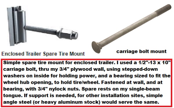

  • Here's a simple alternative, if you want to make your own.
    load locker vs carriage bolt for enclosed trailer spare tire mount.jpg (99.33 KiB) Viewed 2911 times
    since spares are heavy, a bottom rest is advised

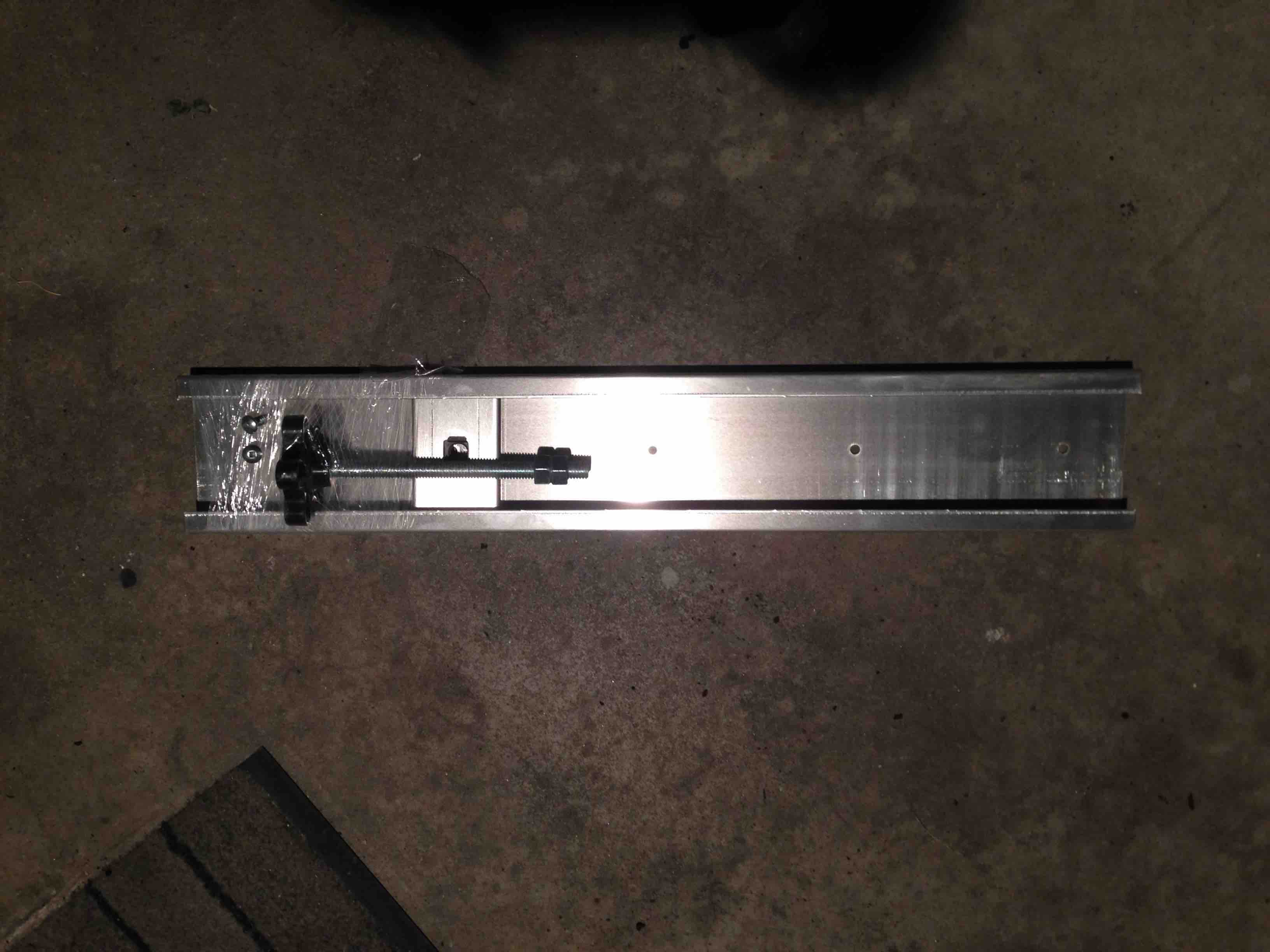

This is the unit I got with my trailer..The frame is aluminum..Down the centre are several holes which I would attach via carriage bolts or similar to a park of the ramp 1" tubing frame. I only see the one bolt to hold the tire on but Im sure I could add a second..Thoughts... or should I look for something more solid
Al

Postby CoventryKid » Tue May 23, 2017 3:43 pm
Al:
Can't quite make out your picture, but as I suggested, I thought 1 bolt to hold a spare on was not enough, so I bought a second unit so my spare is mounted with 2 bolts.
Others have suggested other ways to accomplish the same thing at lower cost.
With the spare at the back, it's out of the way and it does not affect the operation of the ramp.
Hope this helps!
