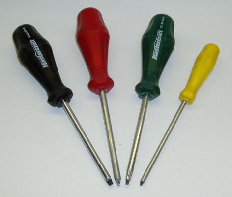

So what kind of bit does the exterior and some interior screws take? Its 8 points and not a torx...can get all my paneling off without taking some metal trim off around the doors.

Postby onehoser » Sat Oct 07, 2017 5:16 pm
freeriders98 wrote:So what kind of bit does the exterior and some interior screws take? Its 8 points and not a torx...can get all my paneling off without taking some metal trim off around the doors.
i use a red robinson screwdriver, works great
not sure about your door but i have to remove the aluminum trim/seal to get the inner panel off. which is on my to do list so that i can insulate and install an rv latch

Postby Rainier70 » Sat Oct 07, 2017 8:15 pm
Number 2 square bit. The screws are a double square

Postby freeriders98 » Sun Oct 08, 2017 9:06 am
Rainier70 wrote:Number 2 square bit. The screws are a double square
Well that makes sense! I'll give that a try. Pretty sure I have square bits.

Postby onehoser » Sun Oct 08, 2017 12:12 pm
sorry, in canada the #2 square driver is called a red robertson, after it's canadian inventor
