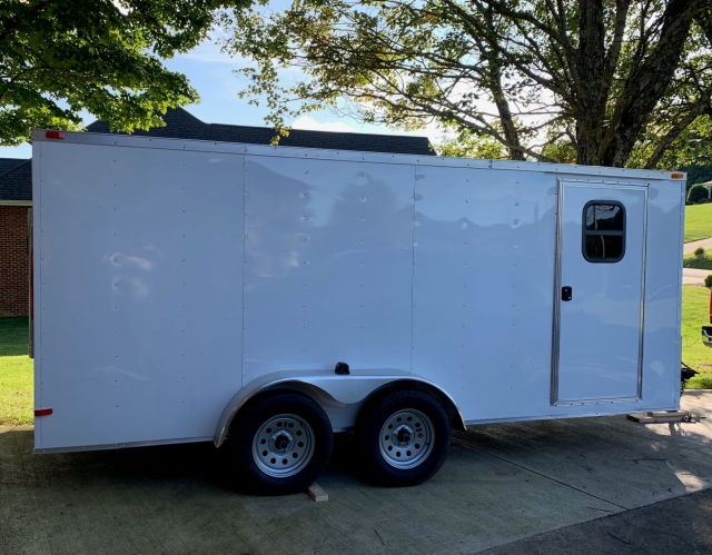

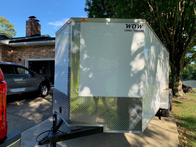

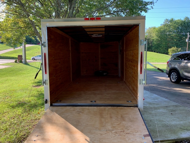

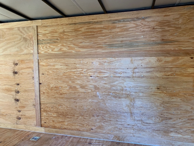

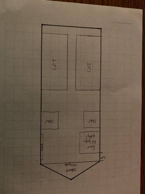

Postby James06 » Sat Aug 24, 2019 6:56 pm
I picked up the trailer today and got it back home. Now to let the fun begin. I will post some pics when I fire out how to make them smaller.
James06
Posts: 66
Images: 24
Joined: Wed Mar 26, 2014 5:05 pm
Location: Kingsport, TN
Re: 7x16 conversion
Postby James06 » Sun Aug 25, 2019 5:57 pm
Here are a few pics:
