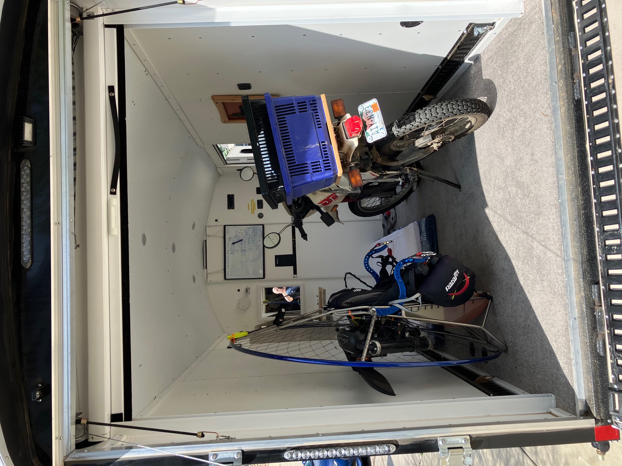

Here is what I wanted to haul in it. A motorcycle and a paramotor, plus have a bed and the bare minimums with me. As you see a 12x6 is barely enough for this. And will take some creative compromises.

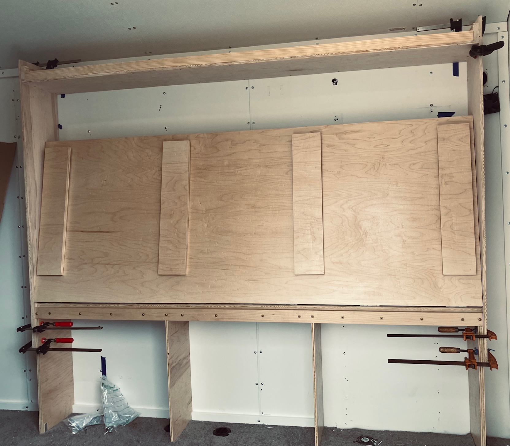

Postby FR CTC » Sun Apr 20, 2025 8:45 pm

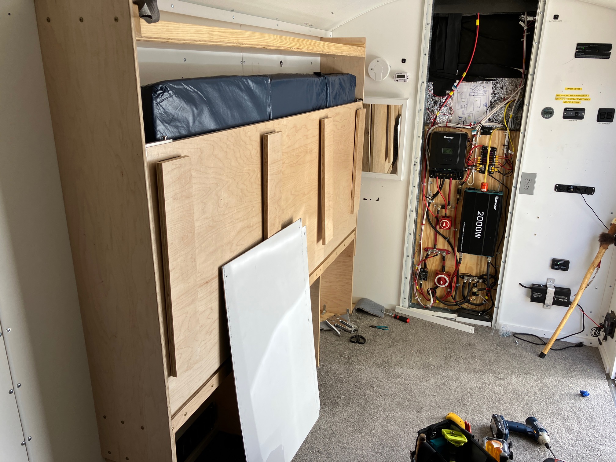

After trying cots, small mattresses I realized as a larger dude I’m not compromising on sleep. So I decided on a twin mattress sized Murphy bed. Here I decided to go tall and place the platform about 24” up. Which makes a tiny shelf space above. I sized it for about an 9” mattress which means a 7” ikea foam mattress and a blanket or two.
If I do this again I will build the Murphy bed to be one unit. The build in place is tedious.

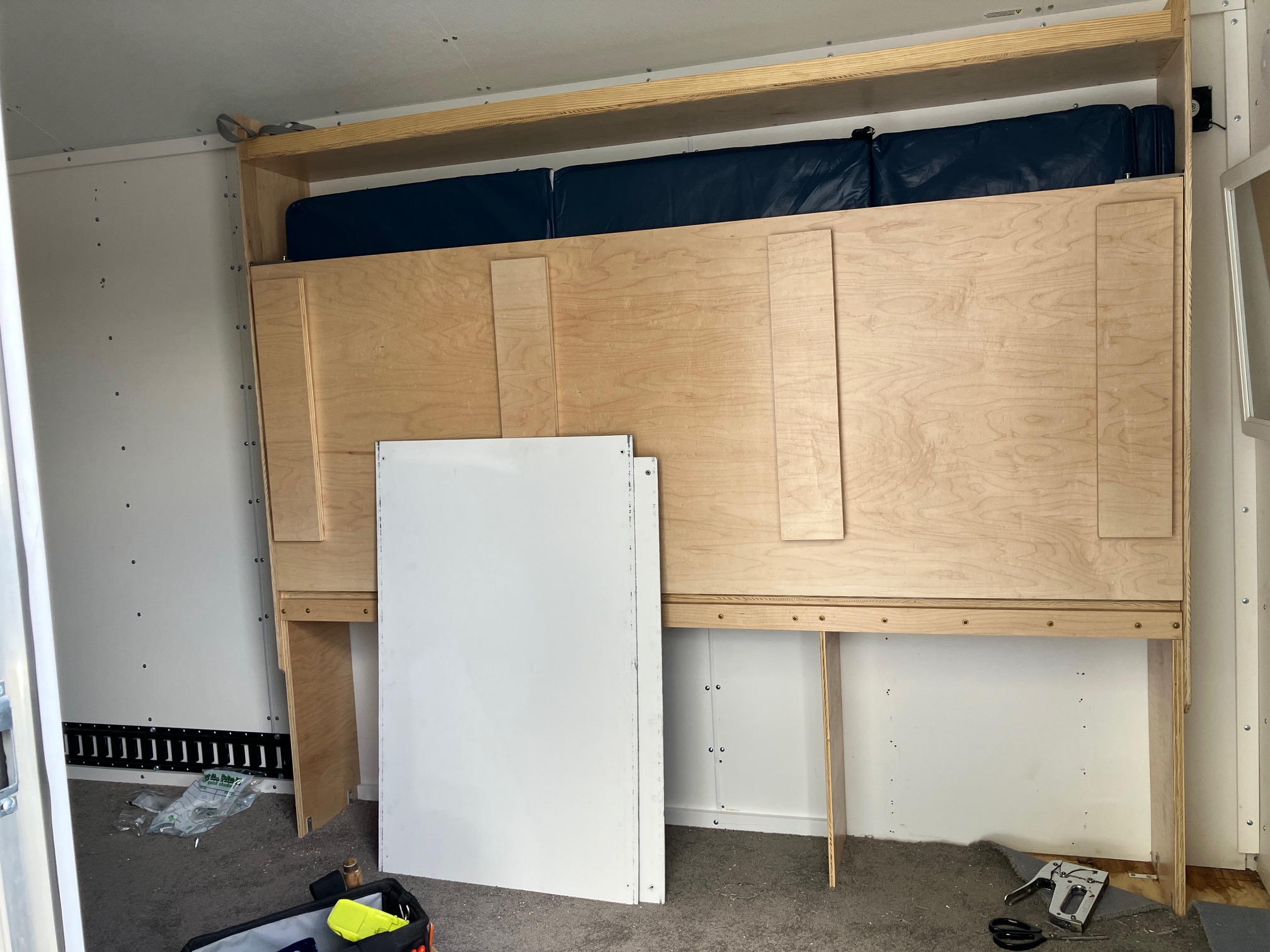

Postby FR CTC » Sun Apr 20, 2025 8:50 pm
The bed as it stands. It leaves just enough room for the Paramotor on the same wall. The motorcycle part is in planning.
Due to some wrong assumptions I put the bed a bit further and should have pushed it forward a few more inches. Oh well next time.
