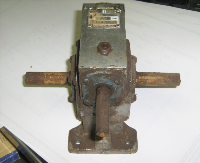

I was brain storming with a fellow at work about my lift bed and he announced that he had just what I needed.........
Worm drive gear reduced power transmission gear box. At 30 to one reduction the bed will be almost nothing to lift up into the cupalo of the caboose.
I will extend the two output shafts to about 2 ft each and incorporate 4" diameter take up spools for the straps to wind up on.

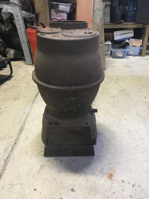

I found a real coal burning caboose wood stove !
Bought it and a 3rd row conversion van couch/bed seat for a total of $175.00

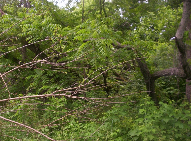

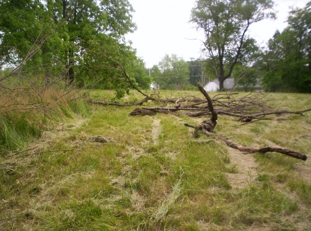

I had all these scrub trees cut and ready to buck to length
and there is a 48" storm damaged oak that is laying 8 feet from the back door that needs to be cut to stove length.
Had I not been being lazy and babying my surgery incision I would have had a lot more done !

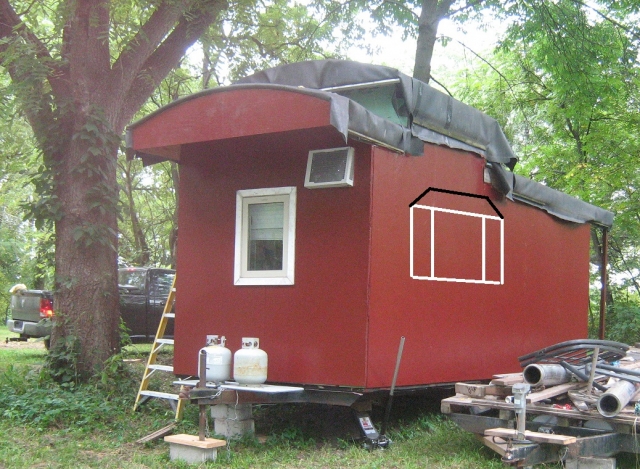

I have pinned down a 3-0 tall by 4-0 wide 2 foot deep bay window with two crank out casement side wings. Heck it even has the screens.
I will pick it up tomorrow night one of the guys at work had it. Not bad for $20.00 Huh?
The caboose was rather plain on the south side and needed a window so before
So here is where it should land. Image
I am sure its a bit out of scale but I am sure glad to have found it before I got the battens attached on this side. Just need to cut out 2 studs and header off and add a couple new king studs and it's in. It will be right at the headboard of the letdown bed at night and behind the couch during the day. I will get pics as it happens.
