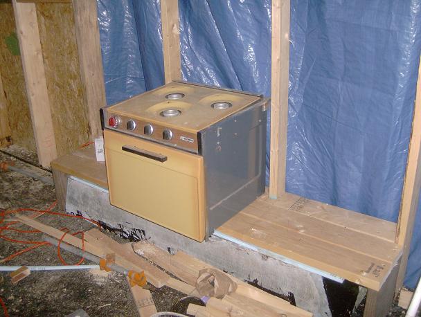

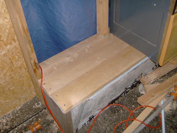

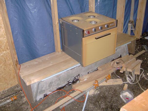

I once again found myself perched in my little caboose in a folding lawn chair sipping a cold one and day dreaming. Unable to contain myself and my curiosity I decided to frame in the right fenderwell.
So insulating the metal with 1/2" foam I then added a 12" extention to the wall framing and built a 2x6 frame over the wheelwell to support the 3 burner stove flanked on either side by the mini fridge and the mini freezer.
As I have stated before I will vent the fridge and freezer to the outside to aid in more effecient cooling and will insulate the sides with durock cement board to isolate them from the stove / oven.

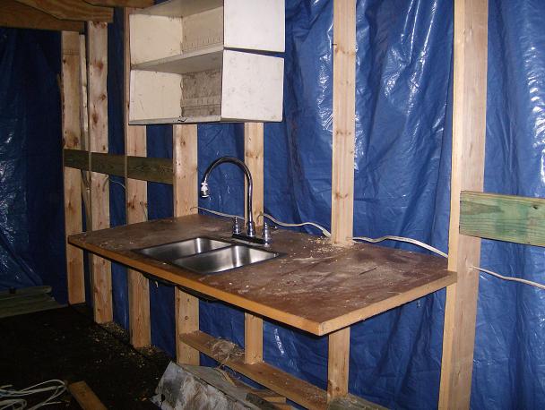

On the opposite wall I took a hollow core door I had laying around and cut it to fit temporary as the counter and sink area. I had several 10" x 30" metal cabinets salvaged from the dumpster at the Ex's work so I temporarily installed them to get a feel for the kitchen area. Even went so far as to cut in the little RV double bowl sink and a faucet set we had lying about.
I got out there early this morning before taking off for work and got these pics.

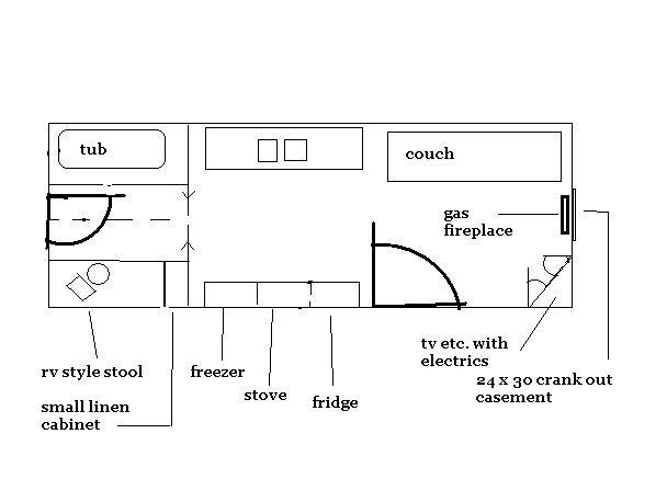

Yep: even I, was having trouble keeping up so here is the latest and greatest floorplan
The bath area will still trombone in and out as needed becoming the hallway to the rear door when collapsed down. This allows me to have a 25+ square foot bath area and a 25+ sq ft toilet area while only costing 20 sq feet total when not in use. The original rv blackwater tank and rv style toilet can be used so the "Litter box" can be emptied from outside eliminating tracking buckets thru the house.
The triangular cabinet will house all the entertainment goodies and at the bottom will be the electrical inlet and breaker panel. I have given up on an active front door. I located a 24x30 vinyl crank out casement window at Habitat for Humanity and will build the front wall with the window centered as a window lite in a faux front door just for the look. Below the window I will install the zero clearance fireplace Heater I purchased last week. The pullout pan storage wall appears to still be dooable but I need to get further down the road to be certain.
My main goal is to get weather tight as soon as possible that means concentrating on roof purlins sheathing insulation and installing the rubber roof and continuing with the sheathing. I am simply trying at this point to see where windows can be installed.
As of this writting I have decided to try and install the little 30 x 30 windows to the right side of the baggage door between it and the corner cabinet and a matching one in the toilet area keeping them symetrical in location.
On the couch side at least 2 possible 3 windows closely mated over the couch area and a single at the other end over the tub area. I would love to have one over the sink but feel the cabinets and appliance wall is far more important. The main baggage door has small lites in it as well to give some natural light. Adding some additional daylight and natural chimney venting will be the cupalo windows lites. I am tossing this out to my wizzened friends to see if I am on track or is there something I may have missed. Any crazy ideas are most welcome. Many of us have learned how to get a quart of pickles in a pint jar when designing and I am sure there are some tricks I may have overlooked.

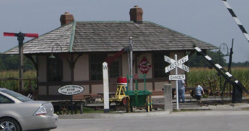

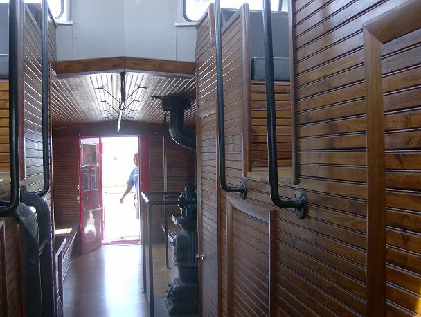

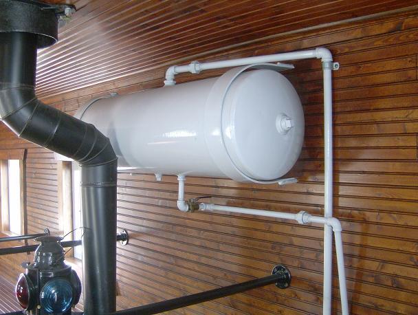

On the way home from the summer gathering I tripped over a small train museum in Monon IN I had to stop.......
