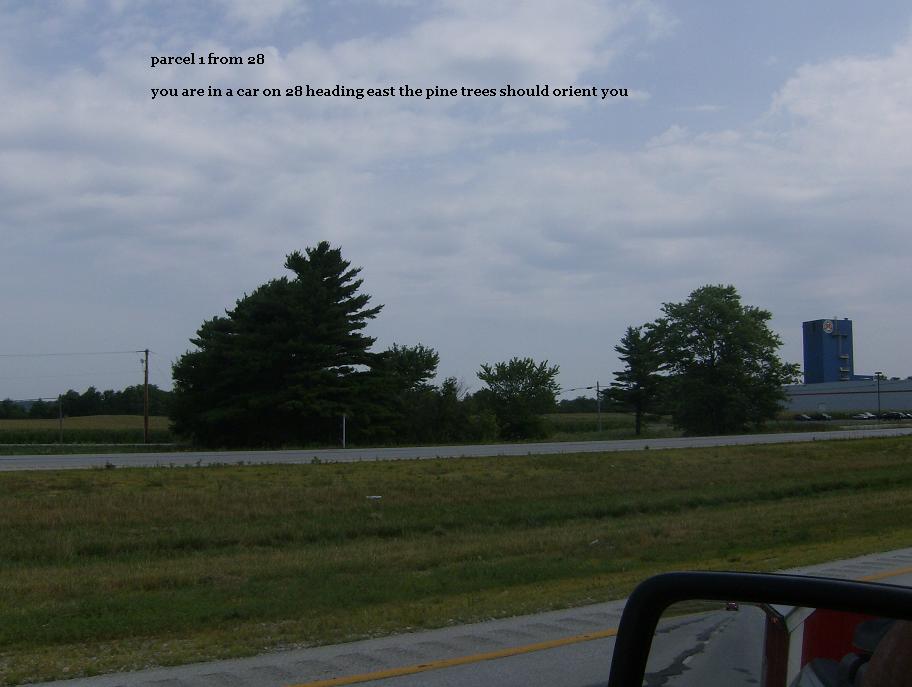

Typical local goverment she had the piece of property she described as on the north side of the road (it's on the south) and they assumed it was the one I was interested in (it wasn't). So at lunch I took pictures of the two parcels I was interested in and took time to edit them and place descriptions right in the picture showing all my "Neighbors" ! Parcel one has a bean field east ,a corn field north, a factory west and the new highway to my south. That makes it ag-1 or light industry 1 not residential 2 as she mistakenly described. This should make the zoning exception a little less of a jump. I went to parcel 2 my second choice and took the bean field to the west the corn field to the north and the 10 year old mobile home to the east and again the highway to the south. Maybe they can help me with zoning exceptions and if not maybe the almighty has a better plan for me that I am yet to be aware of. :shock:

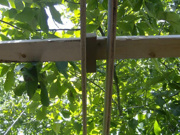

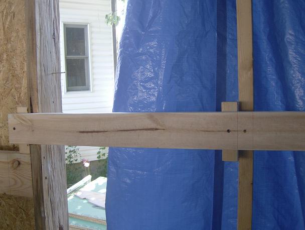

I finally learned how to get the purlins to fit.

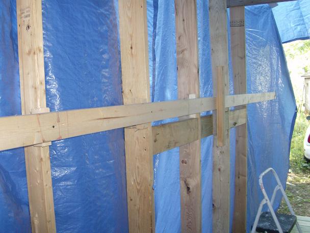

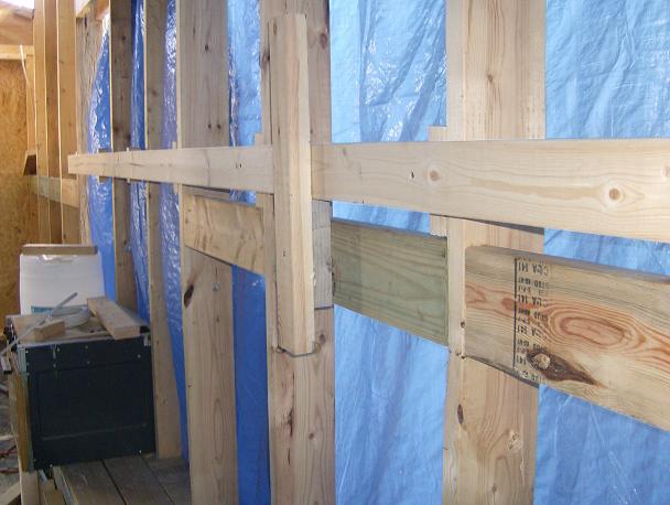

Yep Up to now I had measured and marked to install the purlin blocking. You haul them up and they didn't fit for one reason or another so This became my installation jig.
I moved the puriln forward 1 1/2" and dropped the blocks in just ahead of each stud.
as a final check I flipped it over and slide it into line with the wall studs and checked visually
Made a great place to work with no bending and no measuring

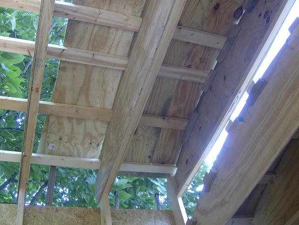

Here is the ground floor view looking up between the plywood truss domes. I will screw thru both faces and draw the plywood tight to the cleats to install.

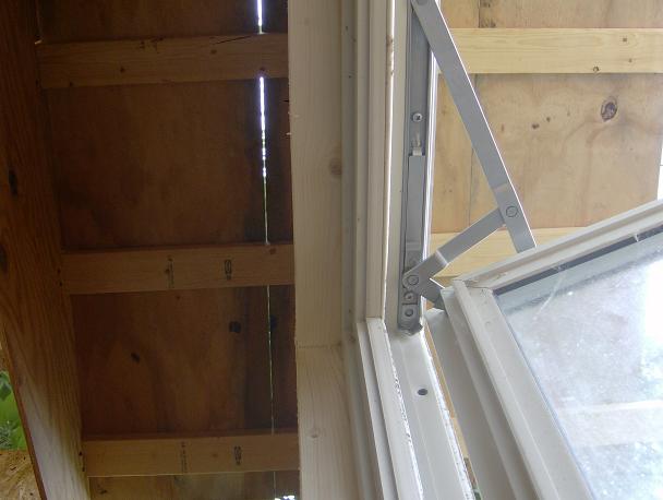

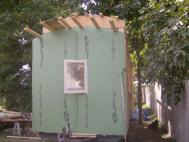

This window will become a faux door
and the baggage door is kinda installed needs stops trim and latch hardware

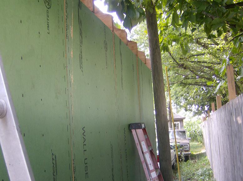

I also have 2 sides now completely sheathed.

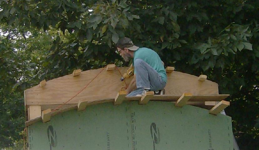

Got the ex husband to help me deck the roof.
(Well he's married to ex wife #1 what would you call him) :lol: :lol:
I was out early and installed the missing siding while waiting for my roofer helper
The cupalo decking.
Here is a stick my arm in the window and click shot (got lucky) showing the lower front roof inside and out over the tongue. Yep a little gap here and there but there will be 1" foam over lapping and then the rubber roofing so it is not a big concern. After all the plywood rips were "absolutely free" scrap waste drops from work. 17 1/4" wide by 8' long.
Got all but 2 sheets of siding on ( the rear wall ) and the roof is about 1/3 decked. I was desperatly wanting the front and cupalo all rough decked but we ran out of construction screws and gave up about 1:30.
