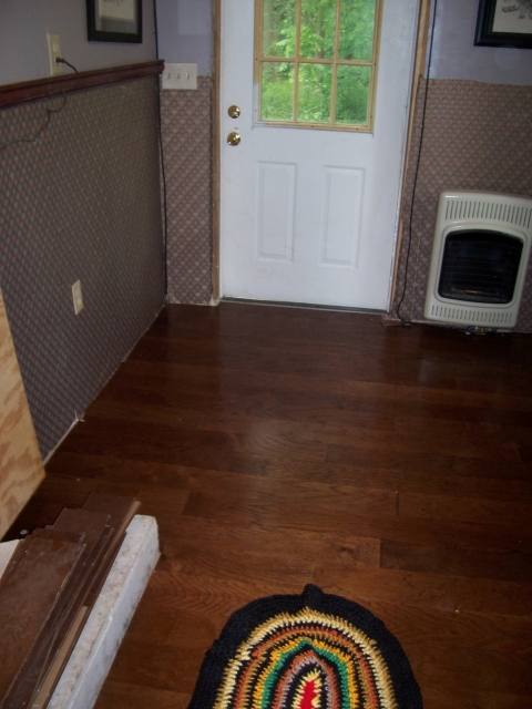

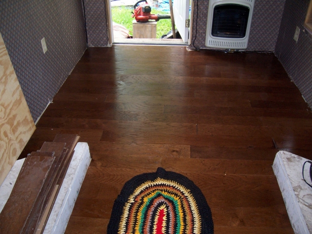

Well the caboose and depot are safe from the horse invasion ! Took time this weekend to clean up things in the depot.
Image Before
Image After
Image The secret to housekeeping in
a tiny house (note leaf blower)

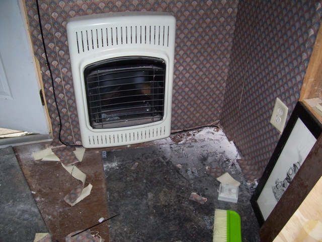

12/15 $40.00 for my yard sale find lp gas wall heater and another $23.00 in piping and such to install
12/30 $65.00 to my helper
1/6 $30,00 for my help and $14.00 in Kreig fastners.
2/8 $40.00 for a new regulator and fittings for the LP heater

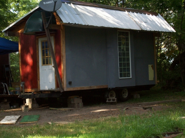

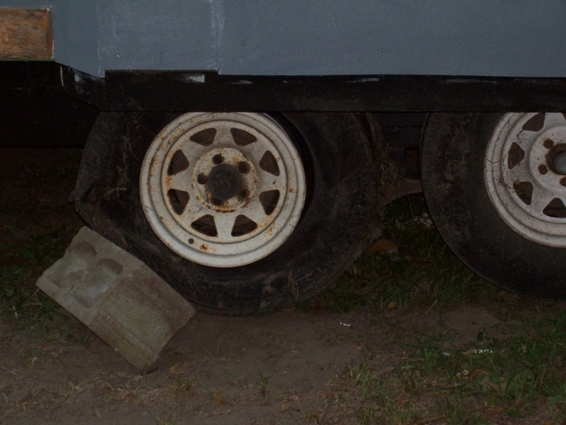

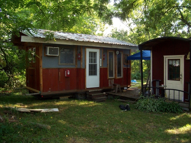

Well here are the pics I promised........
Image the one casualty :x
Image now in place :D
Image time to fluff and buff up the party platform !
Image leveled and on piers.
Some additional piers and a bit of final tweeking when she settles and that is where she will set !

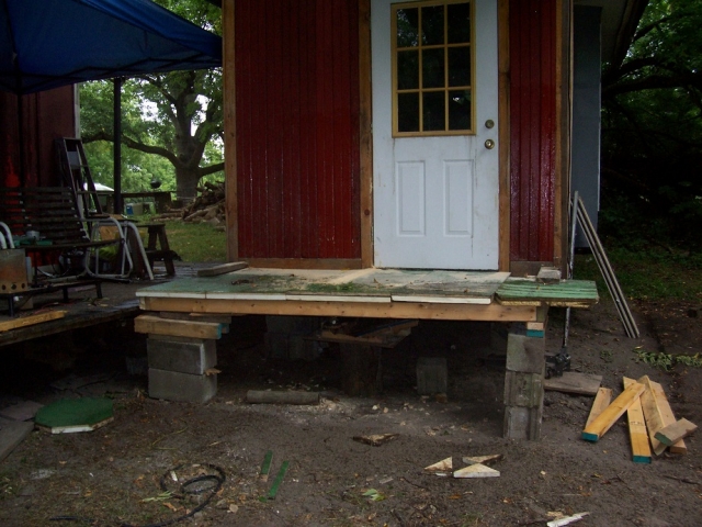

Well the front door now has a 32 sq ft front porch. I have added a temporary decking of zip panel over the frame work and heading to get the fence post sealer to treat the bones then add some 5/4 deck boards for the top. It all sets on the tongue "A" frame with two outboard piers making it a lift off addition in case of a move. I'll get some pics soon but heading out of town for a few at daybreak.
At least the door will be usable now and just a 4" step up off of the Platform trailer......Image
Here is the porch picture ......
UPDATE :Image

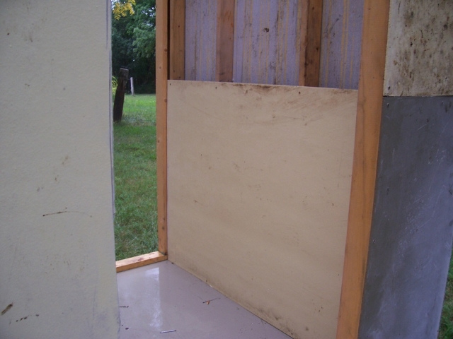

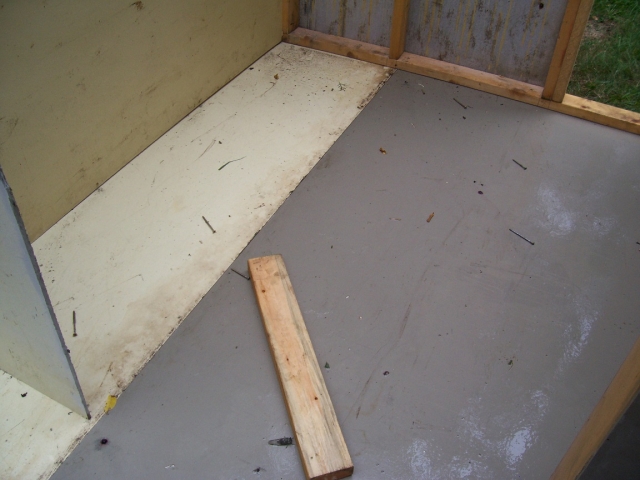

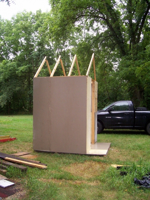

Nights are starting to cool and it is getting dark earlier. All warning signs that winter is creeping up on us so I had my crack crew here yesterday and now have the 6x6 wood stove's out building completely framed. It has all the cement board installed on the exterior and the interior cement board wall lining has a few sheets installed as well. From a pile of salvaged wood and free cement board to a standing building in 5 hours. I cut all the parts and laid out the placement of the studs on the wall plates. I also built the trusses while my crew started to assemble the walls and erect the building. We even used the two 4x8 oak pallets that the cement board was on as the foundation and placed a double layer of the cement board on top of them as a fireproof flooring. Two guys 5 hours was $112.00 well spent. One more 5 hour day and we can be ready for a nice warm fire. Pictures soon.........
Update :
