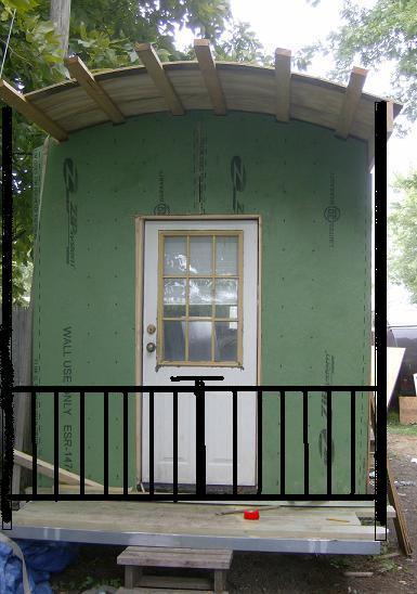

But I digress.... Back to the caboose. While no real work got done I have all the wooden parts cut to finally install the rear platform. The steel rails are 2 1/2" by 2 1/2" steel square tube
so I cut treated 2 by 4's to actual 1 1/2 by 2 1/2 dimensions these will run 90 degrees under the floor planks
tight to each side of both tubes( You might thing joists) then to keep these from lifting a 2x6 ( 1 1/2" x 5 1/2" actual) will be screw underneath the "Joists" forming a "U" around the steel extention. Jacked in place from underneath I will then screw thru the 2x6 deck boards into the "joist" and in the center wher the traffic is heaviest an extra "Joist" will act as a strongback to reinforce the walk way.
I was also able to acquire a matching light steel head board and foot board These will be cut and fit to form the rear handrail. I will try and get it cut and mocked up for a picture this week. I will attempt to edit a rear picture to help you get the idea.

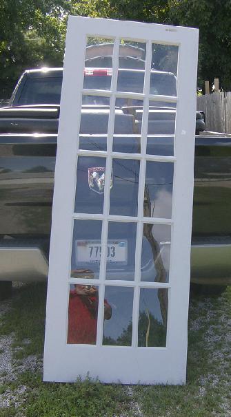

A ten dollar yard sale find on Saturday 30" 15 lite brand new :thumbsup:

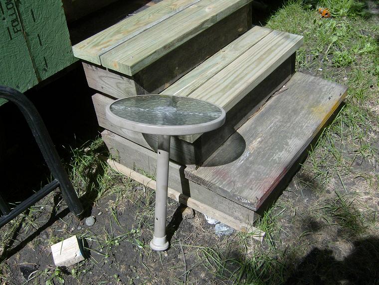

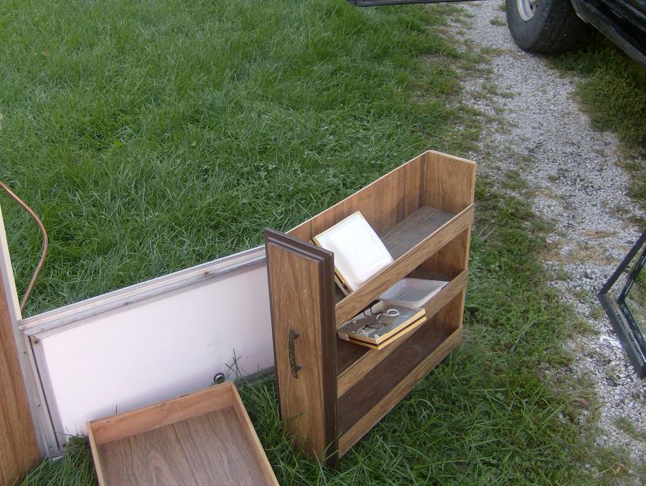

Here is the little table removed from the yard glider I found for free. It will be the brake wheel (cocktail table) on the rear observation platform.

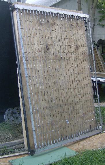

Here is the free mattress frame that I will be using to support the lift away bed that goes in the cupalo when not being used.

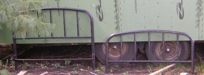

And the bed frame that came with the mattress frame. The headboard will be cut down to match the foot board and these will become the rear observation platform railing with the table being installed between them.

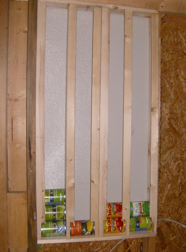

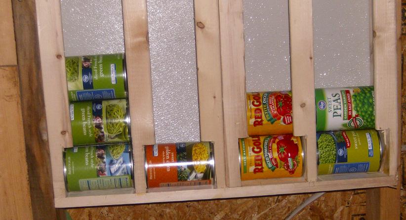

I am thinking about taking this idea and running with it. I would like to incorporate it in the tiny house caboose by fitting it in the stud wall cavities. I used 2x6 wall studs in the build so I could insulate with 2-3 inches of blue foam and still have recessed storage in the wall. This might be a good way to utilize some of that space.
Well the update is that I stayed after work yesterday and picked out 3 of the nicer 9 foot precut studs and did a little creative butchery on them.
I set the saw fence at 3/4" and stretched the blade out to it's max at 3 1/8" I ran them thru and all but cut them in half. I then reset the fence for 3 1/8" and the blade depth at 3/4" and cut out a portion of the 2x4. This left a 3 1/2" deep letter ell with a 3/8" deep lip with a 3/4" deep return. a can get a set of 4 can slides side by side in 22" . The wall studs in the caboose are 22 1/2" wide inside of stud to inside of stud. I will be able to get 2" of blue foam behind the finished rack and still mount it flush in the stud cavity providing can storage with no loss of floor space. :thumbsup:

Here is my version if the in the wall can storage rack! :beer:

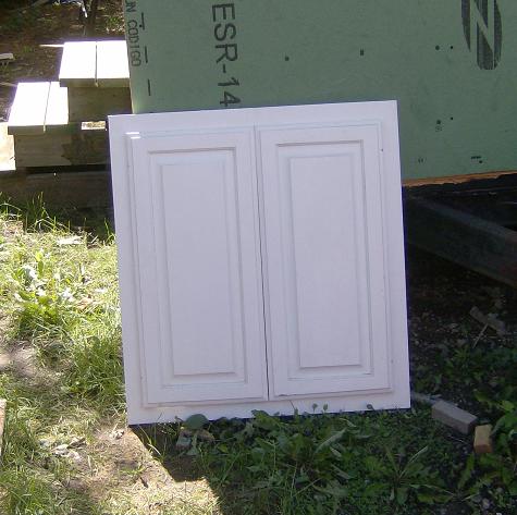

I think I can actually face mount my free cabinet door assembly on the wall over the wall rack.

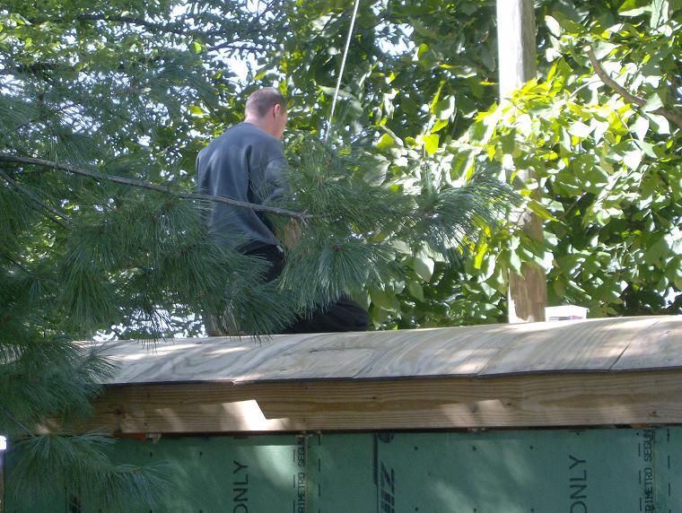

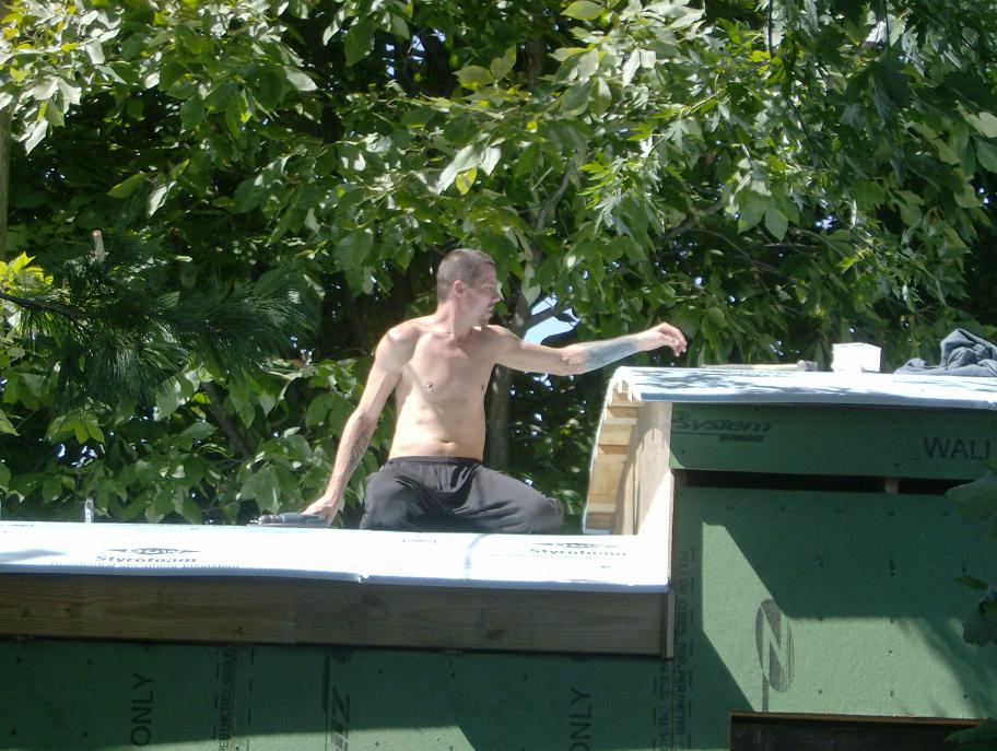

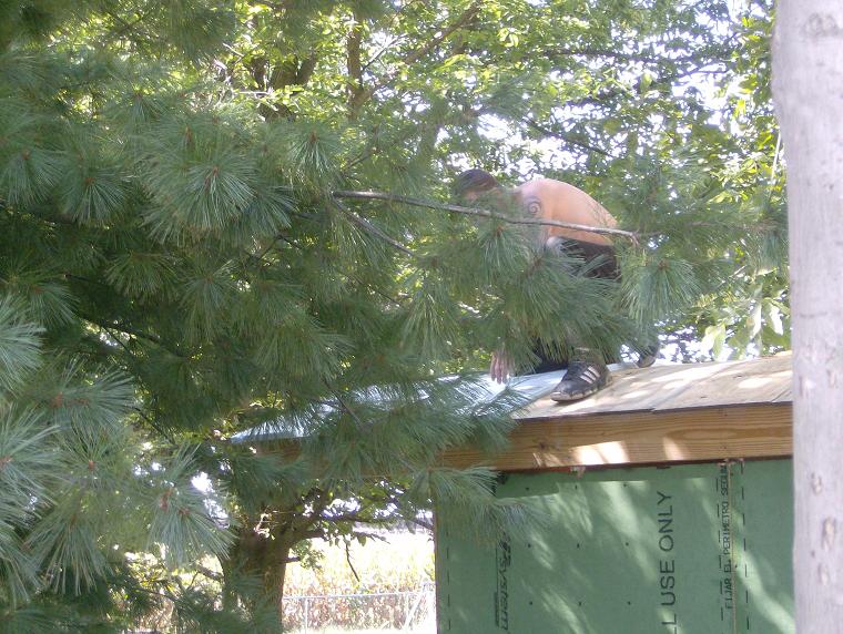

Well the roof is weather resistant....
With the help of my Neighbor Tommy , we got the remainder of the decking and the foam installed. ImageNo more niagra falls inside when it rains. I had had trouble with the last purlin. It had pulled loose and required more blocking than I had originally installed so there was 10 " of roof decking missing and every rain the water poured inside. I was able to add extra blocking and with 3 pipeclamps pursuade the 2x4 to play nice. With the purlin installed I added the 2x8 facia that the rubber roof will be attached to the underside of. ImageFinally the missing 10" of roof decking was screwed in place. The 9' foam sheets were installed very quickly and now no more water inside. While not water proof yet there will only be a few drips inside and I feel much better.Image Image

I cut the bed headboards down to make the observation deck railing.

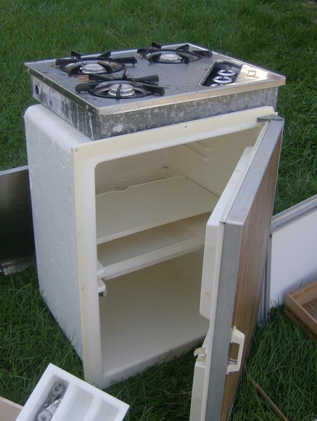

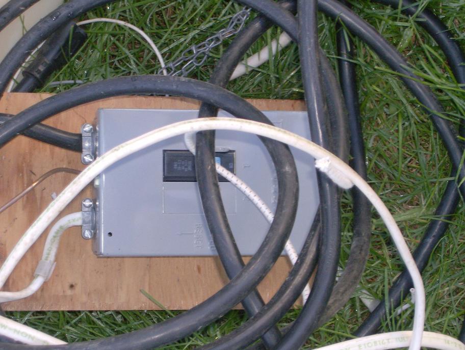

My buddy Bubba called Sat night and was scrapping out a popup and offered me the 8 gage S.O. cord I so badly need. Along with a list of other goodies. 3 burner cooktop, the lift mechanism for the roof ( maybe an answer to the bed lifting problem) ,A converter unit with built in battery maintainer, cabinets, furnace, and I am sure there are others. I promise I'll get pics.

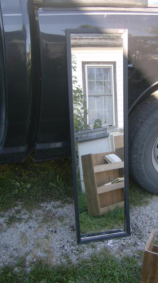

full length mirror for bath area wall a whole dollar

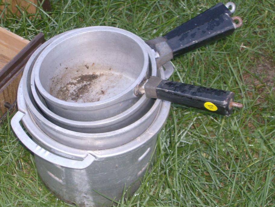

Anticipating no remaining sauce pans when I arrived home I was relieved to find these for a whole dollar ( yep all 4 for a dollar )
figured I had better get to Bubba's and give him a hand demoing the popup as he had told me come out and take what you want so I figured I had better get there and earn my pieces and parts. Boy did I hit gold..........

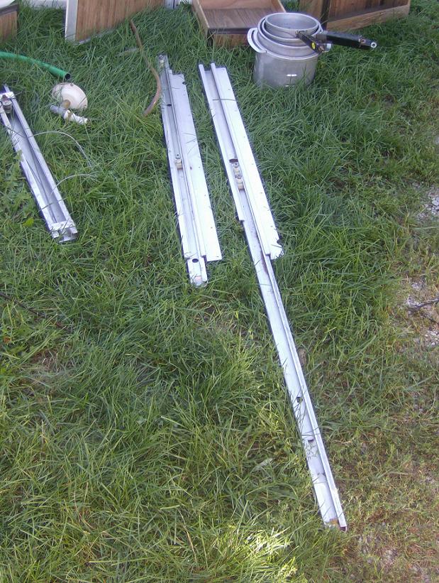

These glides pictured as one extended the other collapsed are going to be repurpose to support the movable walls for the bath area. a "u" shaped wall will trombone out to enlarge the potty area or the bath area when they are in use and shove back and collapse when not in use to make the rear doore entry possible. I was able to get 4 of them.
The corner lifts ( left side of pic above) I am still racking my brain as to how to use them for the lift away full bed that will store in the cupalo. I got the sidewinder winch for the lift
( sorry no pictures ) and it will work but I need 9 foot of lift and the telescopic corner post only lift 4 -5 feet. :thinking:
