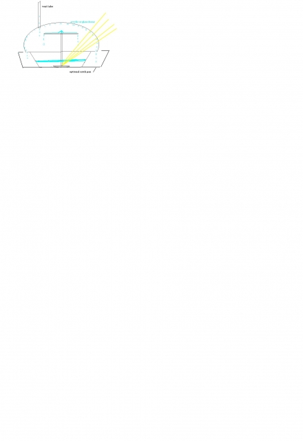

By adding a vent tube any disagreable odors would now be vented to roof height much the same as your standard home plumbing vent stack is done. The mineral and solid residue should be suffeciently sanitized to eliminate problems with them. In this drawing the dome has a vent installed and the dropletts that form on the oversized dome would drip into the outer pan and the distilled water could be used for any planting bed without worry about contaminates.

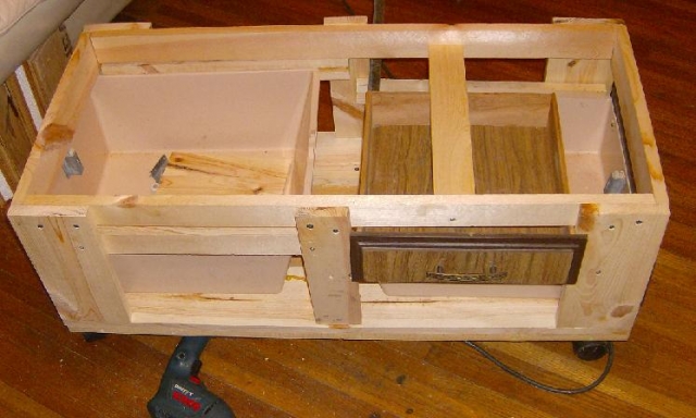

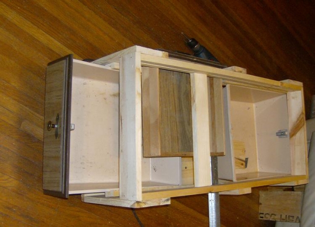

As promised here are the bones of the roll around multi storage coffee table !
Please remember there is not one penny spent on this project at this point ! Even the screws were extracted from the wood cabineted projection televisions I scrapped out. The white pine one bys are scrap from work and the caster base is off of one of the TV's. The little metal "ell" you see in one of the pics originally held in the reflective mirror on one of the TV's and is about to support the little stealth drawer on the side.
I know it looks kinda crude at this point but the ply bead sides and a nice top will dress it up real sweet.
I think it will offer lots of nice storage and serve me well.

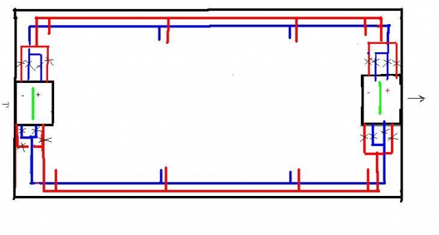

Did someone mention ventilation well here is my hair ball idea.

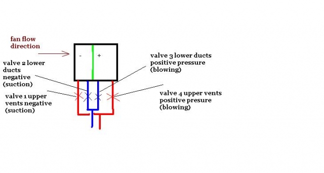

Here is my hvac recycle system. I am going to attempt to describe what I am planning but it may prove hard to follow. An outside vent (10 x 10 or so) is cut into the front and rear wall a damper door is added to open and close the vent on the inside. a 12 x 12 square box is constructed between the plywood roof trusses making it about 22" long. Centered in the middle of this box is a auto radiator cooling fan. By placing the fan in the center I now have positive and negative pressure. At one end of the caboose the fan is oriented outward while the matching fan in the other end of the caboose is oriented inward.
Here is where I am gonna lose ya.....
There will be 3 or 4 floor vents and 3 or 4 ceiling vents of 2 - 2 1/2" pvc on each side of the tiny house. The trunk line that feeds these floor and ceiling ducts will be valved so they can either be positive or negative pressure depending on which valve is open on which side. By opening and closing the valves correctly you can recycle the hot air up and redirect it down to even out the heat in winter. Conversely you can pull the cool air off of the floor and redirect it upward to recycle the cool air. On moderate days you can open the end wall dampers and pull air in one box and by opening all the positive pressure valves you can have all 12 to 16 ducts bring in fresh air and powering up the fan on the other end and opening the outside vent damper and opening the valving on the negative side you can exhaust this same cool air drawn thru for flow thru in and out ventilation. I have the 12 volt radiator fans and have also picked up a couple O2Kool fans that are 12 volt but draw far less current and are smaller with lower cfm capabilities. I am somewhat concerned that running 2 radiator fans long term may stretch the limits of the solar on board system.
Here is my real crude drawing in paint the red is the ceiling vents while the blue are the floor vents. Only one of the 2 valves will be open creating positive or negative pressure at that line. This vent system should also make it possible to vent out offensive bathroom and kitchen cooking odors as well as mixing and recycling the stratafied air layers.
