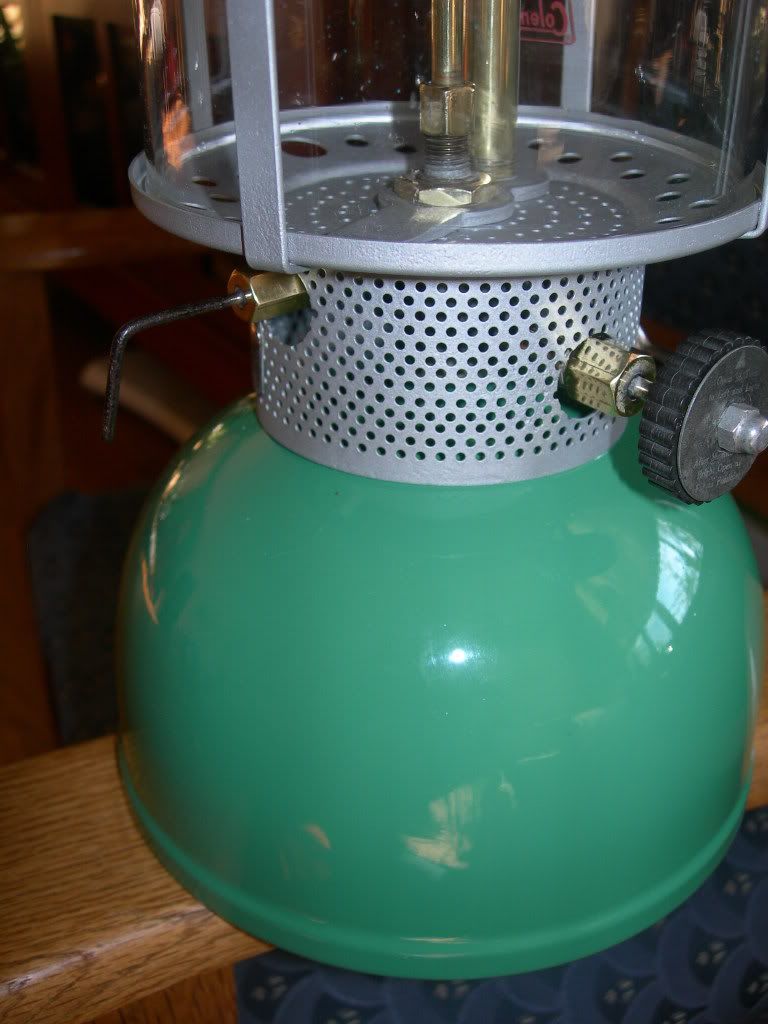

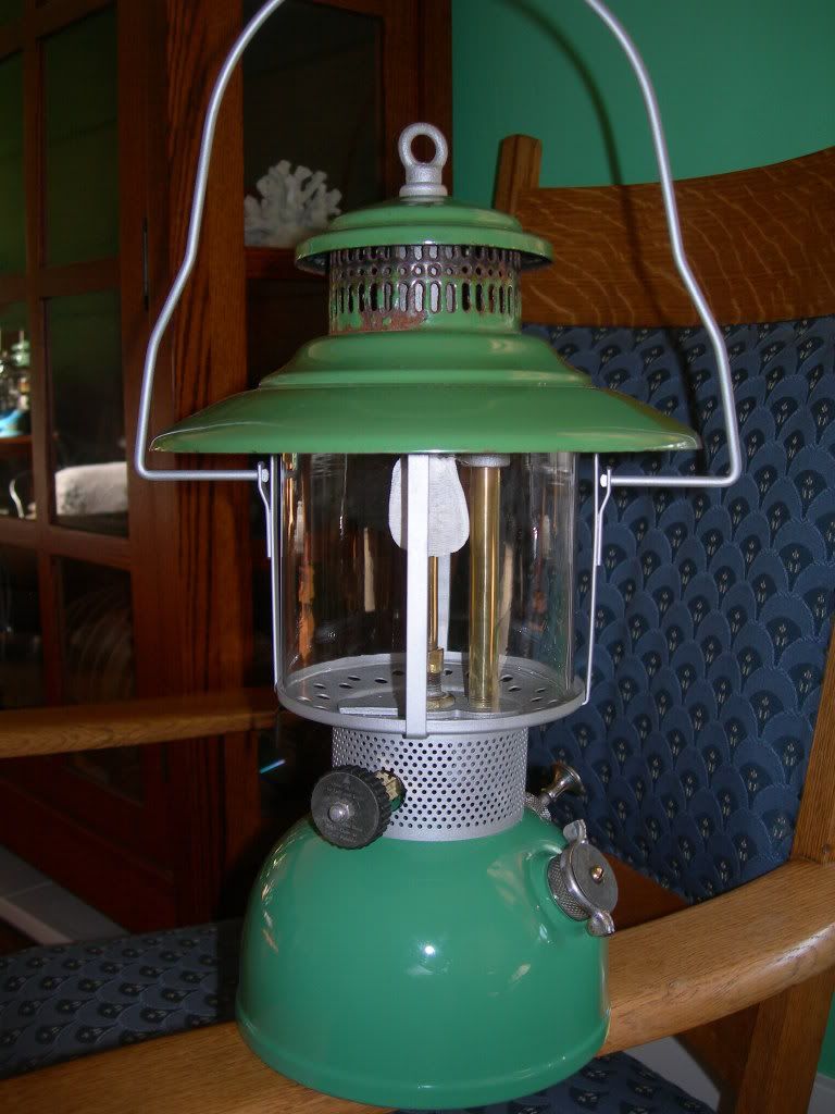

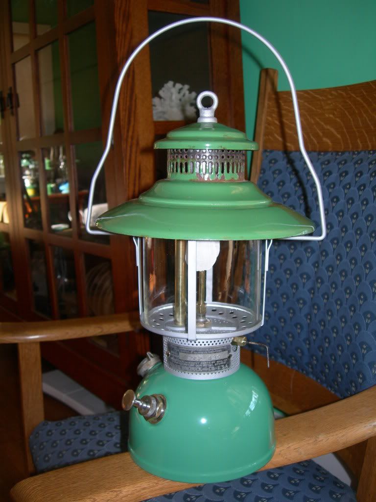

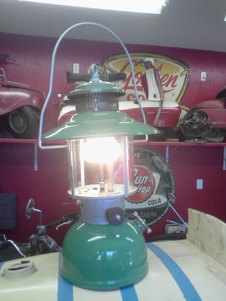

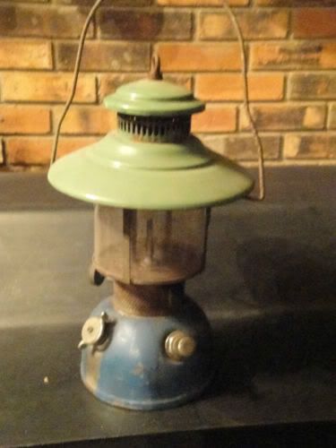

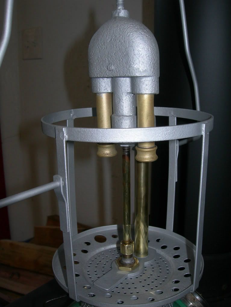

It was very rusty and had a broken globe frame. So; I disassenbled it and took it to a friends and bead blasted the parts. Then I TIG welded the frame back together ans painted it with VHT silver.
I did a bit of research and found the Fount was originally nickle on this model. But; had been painted over because the nickle was shot.
Not having the money to renickle I decided to repaint it.
This is my first attempt at painting a fount and am pretty happy with how it turned out!
