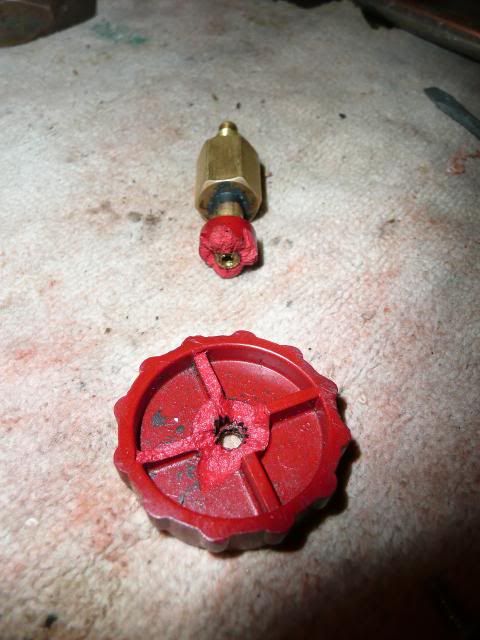

I did however feel that the flame was little hot when I shut the tank valve off, and I continued to hear a "hiss" of escaping gas air so I broke it down again and cleaned it. I must have been a little rough on the valve knob and broke it:
I also found a plumbing washer in the gas cap:
I removed it and I had pressure so I didn't replace the gas cap washer.
All in all a good stove. I just got to buy a replacement valve, or valve assembly. I'll get one Ebay I'm sure. The Old Coleman Parts Site is still down.
Mark
El Paso, Texas
PresTx82
Posts: 657
Location: El Paso, Texas
Postby doug hodder » Mon Jan 17, 2011 10:41 pm
Mark...you might be able to do a repair on it with epoxy, provided that you have all the fuel/oil off the area. I'd try that first, get the piece off the valve stem and build up a fillet of epoxy on the back side. I do have a knob...not in prime condition, has a small piece out of the outer lip on the front, usable though if you want it....free...lemme know. Doug
