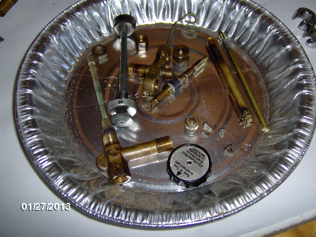

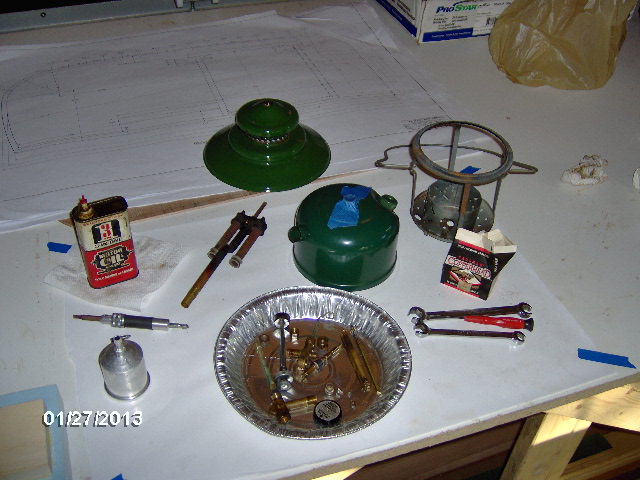

Postby KCStudly » Sun Jan 27, 2013 11:22 pm
Blew the 228E apart today. Started cleaning it up to get it running again.
I’m not planning on a full restoration. No sand blasting, and probably no paint work. Just a general clean up, get everything freed up and running again.
Got the main valve and cleaning needle freed up and did the shooka shooka to clean a lot of rust out of the tank. Didn’t get the check valve out of the bottom of the pump, but don’t think I screwed it up too much as it seemed to hold pressure when I tested the pump on it with my thumb over the port on the top of the font, so…
I still need to clean the brass bits a little more and rinse the tank some more before putting it back together, but I am fairly confident that it will go back together and run.
Here are a couple of pics.
The main valve needed to be heated up a bit and soaked with PB Blaster and some 3 in 1 oil, then allowed to cool before it would break free (tweaked the half coupling in the font some, but should be able to tweak it back fine).
I was able to get the fuel cap apart without any trouble, but the gasket (which ended up being there) was so hard and brittle that I had to pick it out in little bits and pieces using the pick end of my little pencil compass (I have a full complement of proper tools between work and home, and Karl’s stuff downstairs, but sometimes it is easier to just improvise, rather than go fetch).
So a question: does the new cap gasket just get placed with a dry fit, or should it get a dab of rubber cement or something to hold it in place? The old one seemed to be fossilized in place is why I ask.

Postby Wolffarmer » Sun Jan 27, 2013 11:26 pm
Just put the gasket in dry. But taking a gasket out is a whole lot easier with a torch. I hear a propane torch works but I just put the smallest tip on my oxy/acetylene torch and it is done toot quick.

Postby KCStudly » Sun Jan 27, 2013 11:45 pm
Thanks for the advice, Randy. A small spritz of WD40 got the packing nuts freed up easily, and a drop of 3-in-1 oil did the rest on the needle lever. After removing the plastic knob and gland nut, the main valve got hit with a little heat to free it from the font and that also freed it up at the packing.
May still torch the fuel cap button, per your suggestion, to get any traces of the old gasket out; sounds a lot less tedious than my method.
