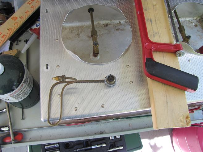

I had an old primus double burner stove, and it had a hose going to a bar, with two knobs, and jets that blew the propane to the burners. I scavenged the bar from that stove.

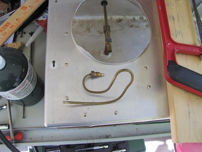

The original piping in the coleman picnic stove had the oddball ends on it to connect to the cannisters. Notice the fitting on the right side of the picture.
I cut that fitting off.

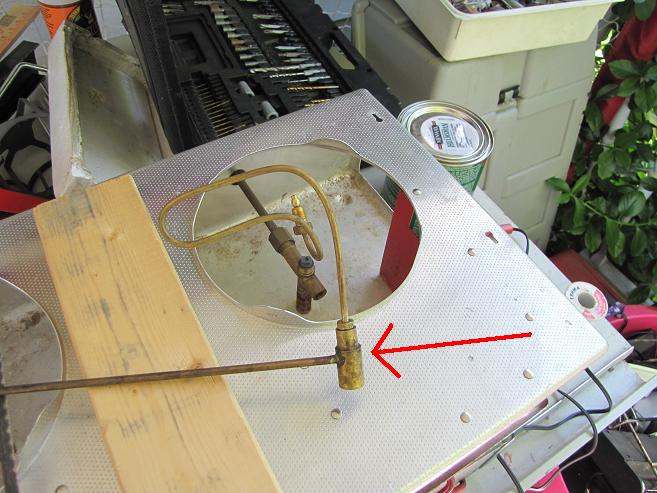

I drilled out the jet in the donor bar, and inserted the end of the brass pipe from the coleman into it.

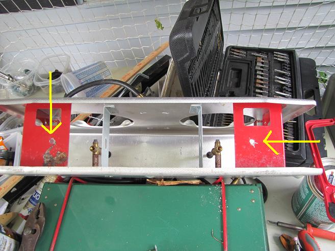

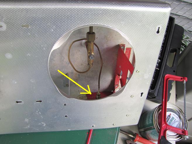

Next I drilled two holes in the support brackets at the back of the picnic stove, noted by the arrows.
I put the pipe back in place, tightened everything and got ready for soldering.

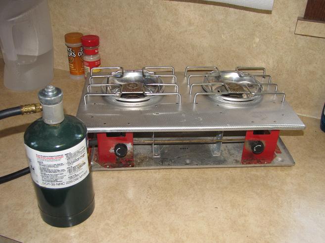

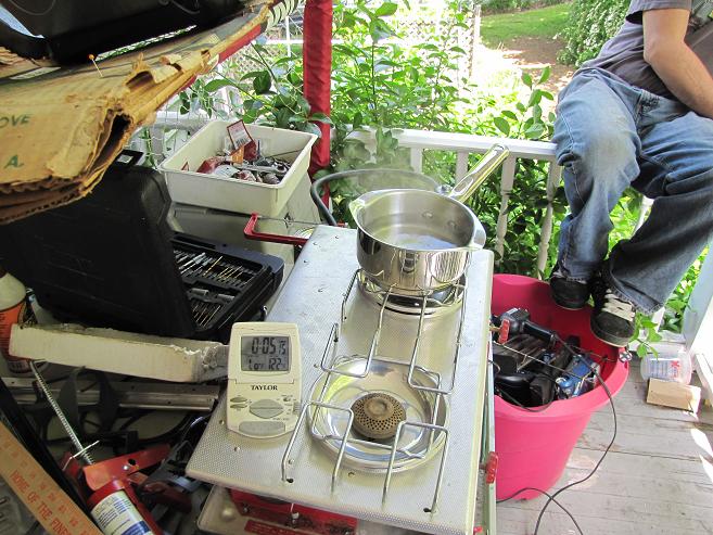

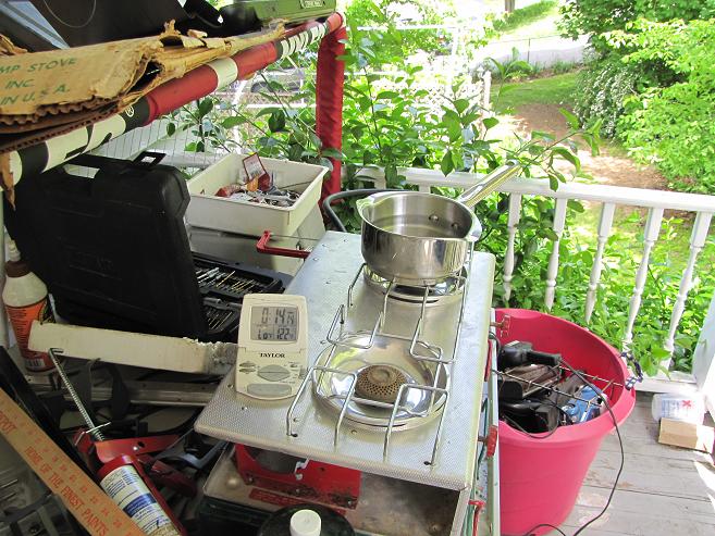

Here's the beginning of my boil test. Two cups of cold water, no wind screen, and a mild wind. The timer is counting down from 15 minutes.
10 minutes later, I had a slow boil!!!!
I ran the same boil test in my house, and the water came to a slow boil in 3 minutes. Now I'm thinking about playing with the hole size on the risers from the jets on the stove, but I have no clue what I'm doing other than adjusting the air/fuel ratio.
My next test will be a bigger pot of water, but I'm thinking a little less heat will probably be acceptable. I usually burn things when I cook anyway!!

I brought the stove in the house, and without wind, it took 7 minutes to bring the water to a low boil!!

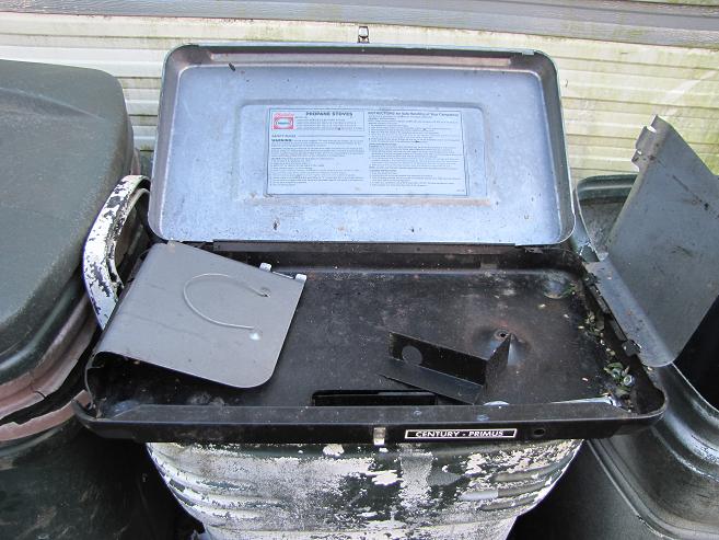

Here's the view from the back, showing the shutoff knobs from the donor stove.

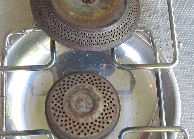

Here is the difference in the burners, the one on top is from the donor stove.

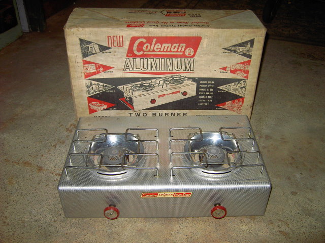

If anyone is interested, this was the donor stove.

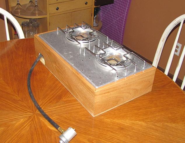

I made a box for the stove to slide into, I wasn't particularly fond of the open sides and back.
I may play with the holes in the burner, I'm thinking that by covering some I may be able to get a hotter flame. Anyone have any ideas?

Postby doug hodder » Sun May 16, 2010 8:09 pm
Paul...that really came out nice! For blocking the holes you could get a LOT of very small screws ( sheet metal maybe) and install them...it would be a hassle, but would make it adjustable by pulling or adding screws. That way you could make a good flame pattern. Just an idea. Good job! Doug

I'm going to get some foil tape to do a test run, but stainless sheet metal screws would be an awesome permanent solution if it works!

Follow up. With the stove in the box, it didn't draw enough air. I drilled two 1 1/4" holes on the sides by the burners for air. One on each side. It burns like a dream.
