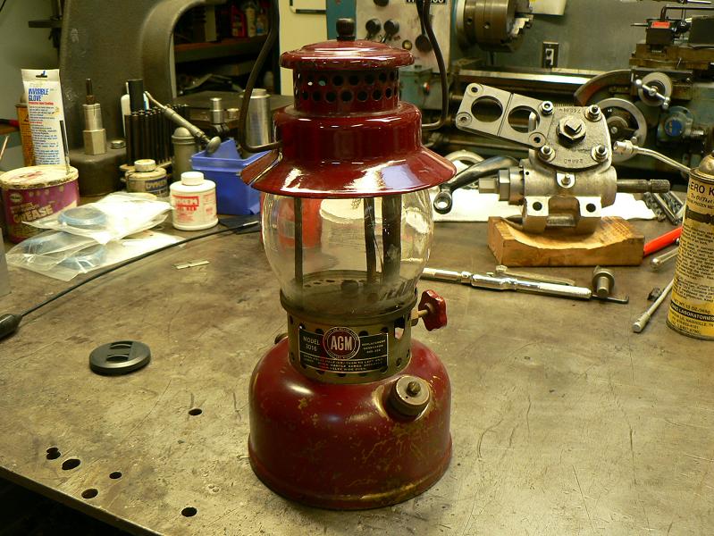

I found this AGM Model 3016 for a reasonable price on the 'Bay. It had a good vent and some nicked-up charm...

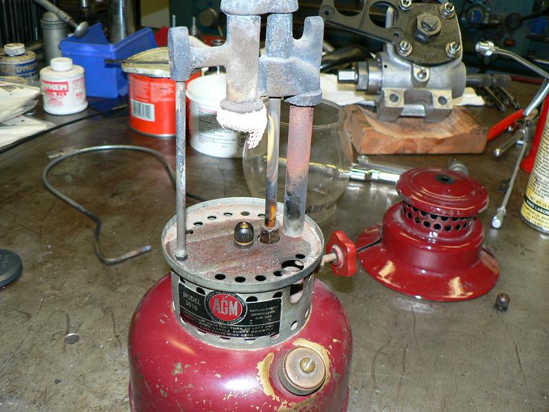

It had been run, apparently, using automotive gasoline. There was some soot and the generator was choked with carbon. I understand these brass founts can suffer from stress-cracking, but this one looks good so far.

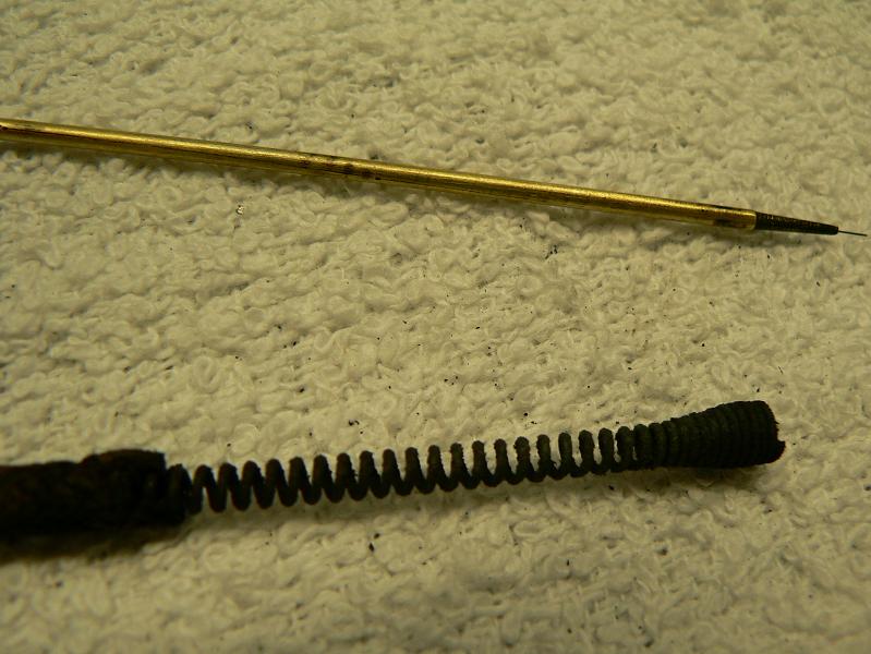

I had access to a friend's beadblast cabinet (pics taken at his shop); I was able to clean the carbon from this generator rod and needle using steel wool, the asbestos rope tube was serviceable and I blasted the generator spring (after this pic was taken)...

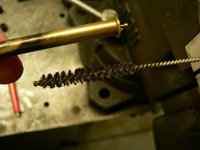

Rather than attempt to quench the carbon from the interior of the gen tube, I placed a wire bottle brush into a vise and reamed out the generator tube.

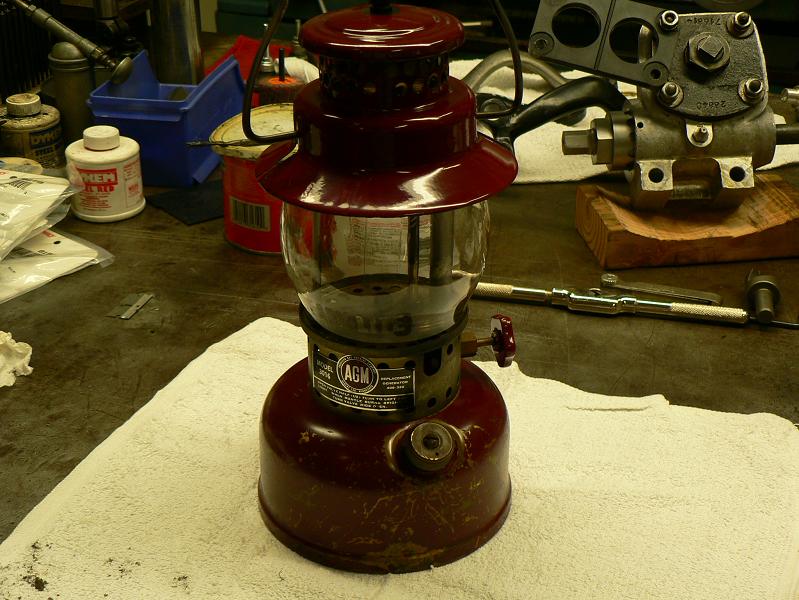

A little water, a little Kroil and some paper towels cleaned up the fount and vent. I washed the globe w/ liquid hand soap and water.

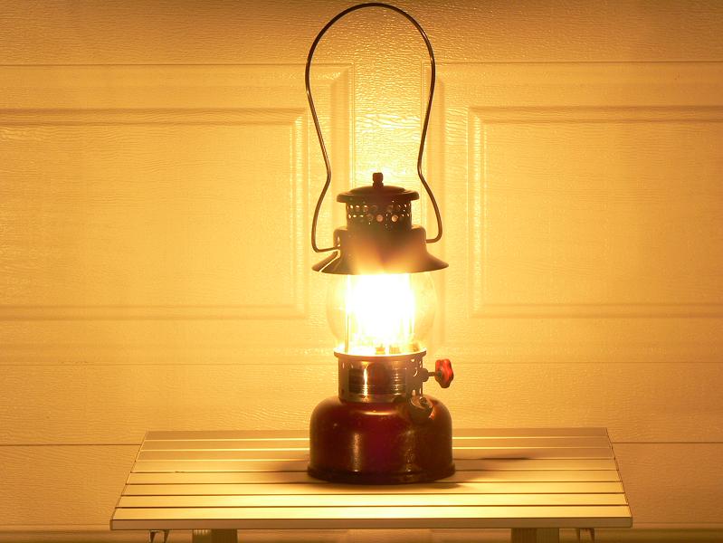

This thing is amazing! What a heart! It burns brighter than most of my other lanterns. Very happy it's mine and that through the information here that Frank Bebb and Bob Hitchcock have posted about overhauling lanterns, I was able to bring this neat little machine back to life...

Nice job Chris!!! watch blasting a spring, smaller ones loose their springiness and want to really warp when you hit it with a blaster. That's what happened on the HandyKook I recently did, carb cleaner works well on any of the bad carbon. Doug

I'll give you another helpful hint - Navel Jelly does a real good job of dissolving carbon deposits and cleaning brass - It takes a little bit of brushing with some steel wool, but it will come off and yield good results -
