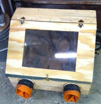

I built a blasting cabinet to help with cleaning up the lanterns, always wanted one and now had an excuse to build it. The best part is I had all the parts except the blasting gloves and walnut blast media.
The blast cabinet....

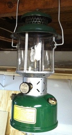

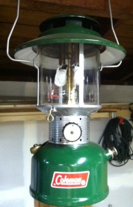

Now on to the lanterns, both were rust buckets before...
The 1945 220C Image
The 1970 220E Image

Nice work! We have an aluminum oxide blaster at work..I'm not sure I could fit lantern parts in the cabinet, but if I ever get the dang thing apart I may just try...

I would guess aluminum oxide could wreck havoc on brass, why I went with the walnuts shells. Takes a little longer to strip rust but rather than then pitted brass.
My next step is to setup a zinc electrolysis tank for galvanizing collars, cages and stove burners. Need to get a couple more things squared away in the garage to decide where I can setup and how much room I can dedicate to it.
