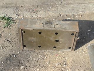

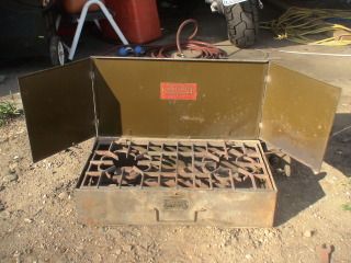

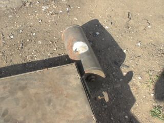

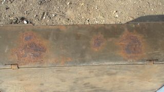

I called made him an offer(darn he jumped to fast)bought it. Some surface rust but not too bad. The guy clean out houses to be demolished and found this, had the pump(external pump) but he thought it was just an old grease gun, so he didn't keep it. :cry: So how difficult will it be to find a pump, and where? or is there something else I can make work. Will post pics as soon as I can.
Here are the pics

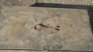

even included the wrench
tinkered with it was going to spray down the legs, because where swivel looks rusty and couldn't find any wd-40, doh.
Anyone (Doug?)have any resources for AGMs?

Postby doug hodder » Sat Mar 17, 2012 9:46 pm
Hey...if you decide you don't want it or want to mess with it and would like it to go to a very good home...let me know, I'll pamper it and am more than willing to pay.
You should be OK on any of the parts on it I'd bet, just take your time with it and don't get carried away. Any parts you may need like a generator fuel pick up in the tank etc... are tough to come by. It'll take another parts stove. Many times, I don't even remove the generator from the brass T. You can pick up an external pump on E-bay...that's not a big deal. To take it apart, there are 2 L shaped tabs under the back edge. You may need to tap them out with a plastic faced mallet, but once removed, the grate and the top lid and wings will come off. A much better deal than what Coleman cooked up to attach theirs. It's a very nice stove....I've got stove envy... :envious: Doug

Got the manifold out, I must have been really lucky, or the pb blaster did the trick, I was afraid of breaking the screws, I shot them with oil and let it sit overnight and then found the best fitting screwdrivers I could and just applied gentle pressure, also got the burner pieces off, the same way. The secondary burner valve was stuck so I sprayed it with oil, then let it sit overnight and the plug and valve came out, (hope I didn't mess up taking the plug out of the end of the mainfold)then was able to free up the valve, I also ran a rifle brush through the manifold, didn't find any signs of creepy crawlies. And did the bb thing on the tank, will do another round or two with bb's tonight. What should I use to clean up the burner parts?
A few questions concerning paint, what is a good match for the case? And what is the best way to remove the original paint? Am thinking about painting the manifold and grate with high heat (Eastwood has 1500degree)cast iron paint, and was wondering if it would work to cure it in our powder coat oven at work(400 degrees) my biggest fear is that the heat would do bad things to the cast iron.

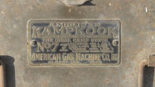

Anyone know an aproximate age for the #7? I think the last patent date is 1924.

Postby doug hodder » Tue Mar 20, 2012 8:04 pm
Regular VHT paint from the hardware store will work on the manifold. Powdercoat is right at the upper limits of it's temp range...and they weren't done in a powdercoat to begin with. I don't think they were even painted originally. For a total restoration, I strip it with Jasco, hit it with the pressure washer, then sand the rest. I strip all the paint off. Before you do that, If you don't have the ability to mix and spray your own paint, I'd get a rattle can matched at an automotive paint store. Chances are, you won't find a really good match in an off the shelf rattle can.
As far as the age on it...I don't have the official book with all the dates, but I'd put it between 1925 and '30. If I'm spending some time in the Coleman archives, I'll do some digging to see if I can get it closer. Doug
